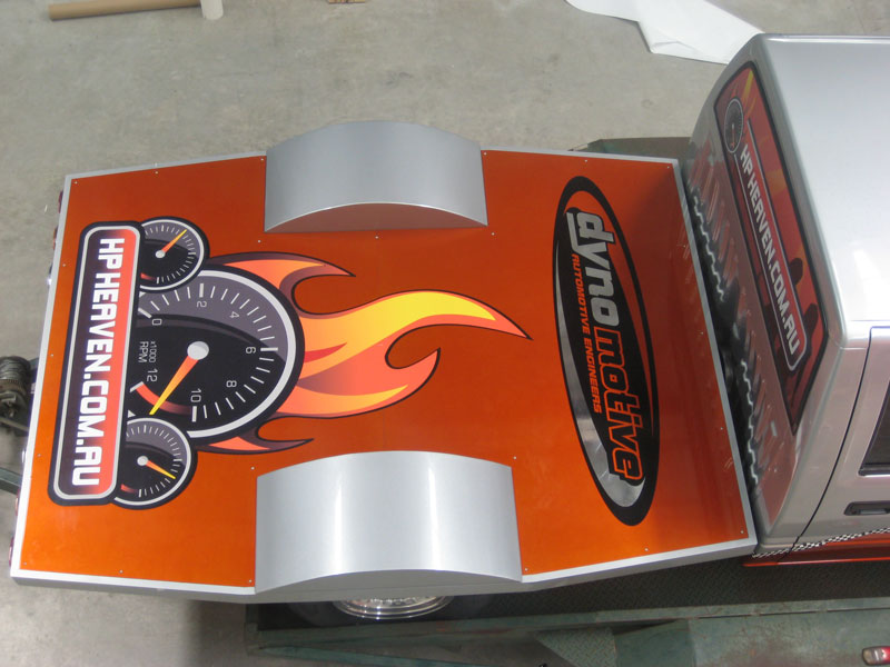

    How do you die cut? on the print and cut, or with a separate machine?

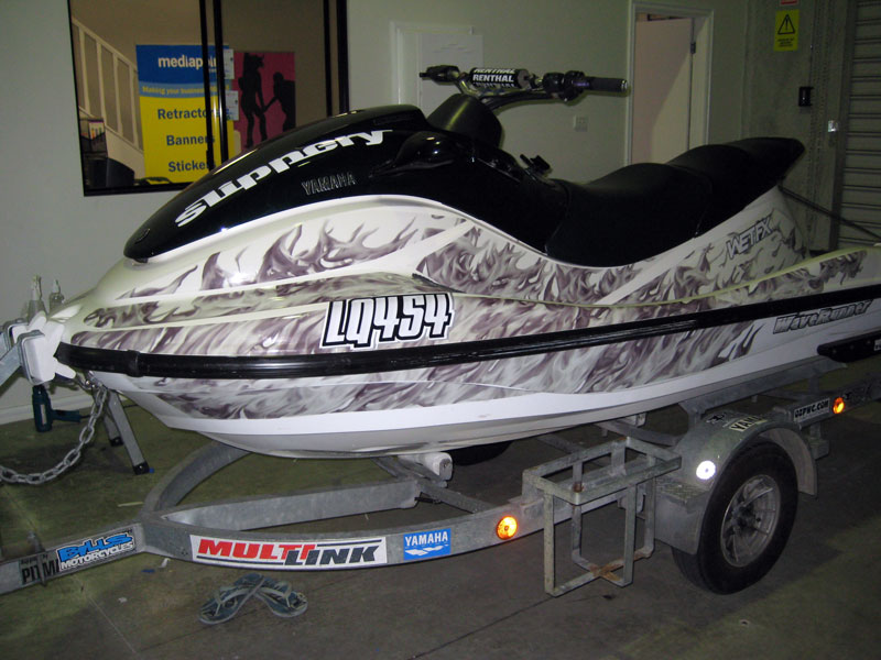

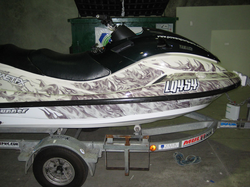

    We bought a graphtec cutter a short while ago. Awesome machine. It allows for intermediate reg marks so I can cut long lengths of print and cut without any problems. Longest I’ve done was the jetski which was about 6 metres.

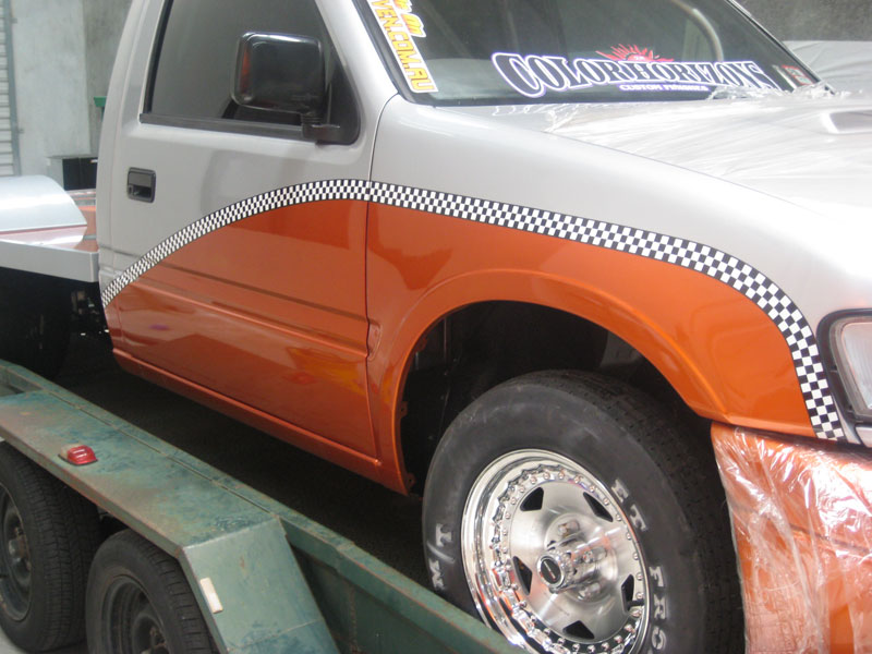

    Hi, sorry if I’m asking a stupid question – but how do you cut for the door?
    I presume you cant do it automatically, so you’d have to do it manually – but then how would you do that without damaging the surface..?
  • Jason Xuereb
    13 December 2008 at 01:20
    Michael,
    Not sure what your asking. But the racing flag strips on the doors I did by creating a template on the vehicle. Then recreating it in illustrator.
  • MichaelThomas
    13 December 2008 at 01:24
    Sorry, I’ll try and explain better.
    Did you apply the flag, then cut the lines down the door – or did you put the lines in when designing the graphic?
  • Jason Xuereb
    13 December 2008 at 01:26
    That black and white portions are a print and cut one piece. I didn’t apply it like a pinstripe. I actually cut it to shape so it was applied flat even though it curves. Uses more material but I get no wrinkles etc in the application.
    Nothing is cut on the car.

    I am sure the jetski was a pain with all those contours.
