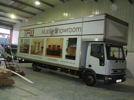

yes I did the layout, customer didn’t want a full wrap and his other lorries also have large pictures on so kept it similar yet different yet simple.

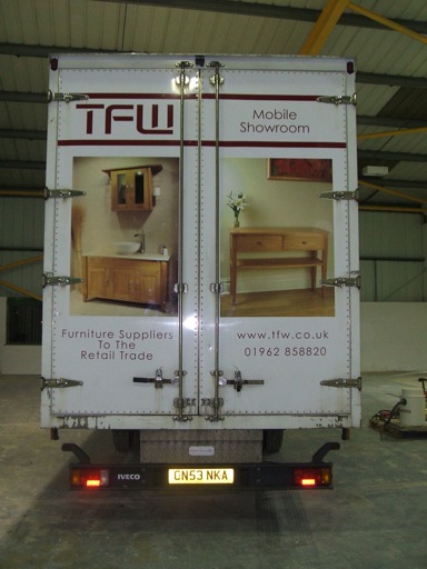

Peter, I used trestles (you can see them in the picture at the far end of the lorry) Yes it was a lot of work doing it alone and had to do centre hinge for the graphics because of the rivets, the rear was done top hinge and let it hang so was a bit easier.

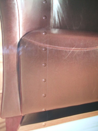

On a side note about the rivets, anybody doing graphics over rivets must must must get a Roller Pro, this is my first ever job with rivets and bought the roller pro just for this job to try out, I first used the rivet brush and thought what a load of sh1t, I’ll never get this lorry done in a month of Sundays 😕 Took the roller pro out and swoooooosh, entire row of rivets done (after a bit of heat of course) the difficult part was ensuring the was a full air gap/tunnel going all the way up for the air to escape otherwise it just creates a big bubble and creases (there was a bit of a learning curve 😳 ) once I go the hang of it I was flying through the rivets no problem and have no idea what I would have done without the roller pro (this is starting to sound like an advert :lol1: )

not an easy thing to do a job of this size, well done and thank you for taking the time to post the pictures.quote Warren Beard:once I go the hang of it I was flying through the rivets no problem and have no idea what I would have done without the roller pro (this is starting to sound like an advert :lol1: )NO NO NO not at all warren… this is exactly what "i wanted to hear" about this tool! I have one in my fitting box and have only had a quick play around with it and although it quickly shown me what it is capable of, it also proved my first thoughts on the device and that was there was a nack to it, like most things! i seldom do work on vehicles with rivettes so i have lacked motvation to dig my rollepro back out my box. however, it is great to hear from you that it does do the job with a bit of practice and does the job well at that.
from your picture you look like you have managed a top-notch application over those rivets mate! 😉 -
