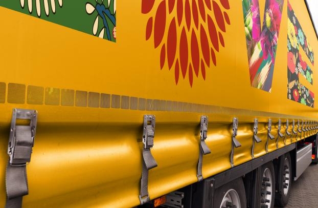

    I have three large curtain sided trucks to do and I haven’t had very much experience with the banner type PVC curtains. Normally I would not get involved in this but it is for a large customer of mine and I get the cabs and rear to do also. so it is a pretty big deal for me.
    I have come across the following truck curtain vinyl and intend to make some calls on Monday regarding it.
    https://www.mactacgraphics.eu/en/product/macal-truck-tarp
    Has anyone used this stuff and what are their thoughts?

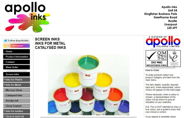

    Or you can mask and paint with screen ink, I use Apollo Inks and Metamark Blue mask.

    If ever in doubt, use ink!
    I used to ink curtains for as long as I can remember.
    I would cut a stencil in oracal paint mask and use a 4 inch short hair roller with apollo inks.
    you require very little ink at all, mixed with thinners.
    We have a spray room setup too, we used to spray all our banners with ink and letter.
    obviously, this was long before digital printers came along and these new curtain materials.
    but never ever did I have a fail or a concern after ink’ing a truck curtain.
    http://www.apolloinks.com/
