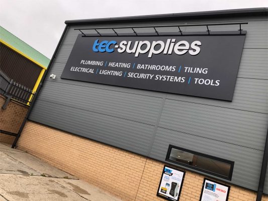

    Did this one a couple of weeks ago, went like a dream

    Nice job Martin, where did you get the trough light, looks similar to ones we bought in a month ago

    Nice big sign martin, great to see! 👍
    it looks about 2.5m deep, is this aluminium or composite?
    assuming you have multiple panels joining across the length of the sign, how do you create your joins mate? they look nice and neat and flush.

    Hi Kev,
    The light was supplied by the client being electrical supplies.
    I actually use Ashby trough lights now, LED ones look so much better these days than the old tubed versions.
    Hi Rob,
    The sign 7400 x 2440 is alluminium in 5 section,
    Vertical interlocking bars on joining edges, fitted together beautifully.
    Tray supplied by Ashby.

      Really nice job mate. Was it tricky to fit it going uphill? 😀

    Great looking sign and big!
    just out of curiosity martin. how did you support the middle areas of the centre trays?
    I mean, you obviously do not have returns in the middle, so there will be a flex inwards, or do they have spacers to hold it out from the wall behind the panels or something?

    The sign 7400 x 2440 is alluminium in 5 section, Vertical interlocking bars on joining edges, fitted together beautifully. Tray supplied by Ashby.
    Do you mean a bit like a tongue and groove join, Martin?
    • Martin Cole
      June 7, 2021 at 1:47 pm
      Correct Rob, it makes joining the panels much easier and neater.
      Hi Jeff,
      No support, in the middle, just the top and bottom rails.
      The fixing bars on the edges helped make the panels rigid even at 2440 deep there was no flex at all once fitted.
      If it was ACM it would have needed more strengthening strips for sure
      Being ally it was a fair weight so we screwed the rails right through the building into thick wooden batons that we fitted on the inside.
      Lol Kev, It was actually on a slight slope😉
