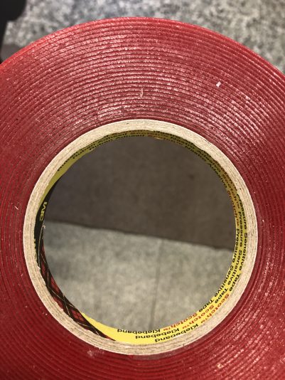

    I plan to fix with double sided tape 20mm acrylic to the stern of my boat and then screw my Garmin transducer. I will take readings on few fishing trips, few different positions on the stern for the transducer, and then when happy with best location, permanently use proper fixing / drilling, sealing into the hull.
    The “nastiest” “stickiest” double sided tape that you have ever used?
    I will be happy to get the name of the 3M foam tape used on the GoPro Action Camera parts. That is the strongest I have used.
    Pane Talev replied 2 years, 10 months ago 5 Members · 6 Replies
  • 6 Replies
  • Pane Talev
    May 25, 2021 at 6:44 pm

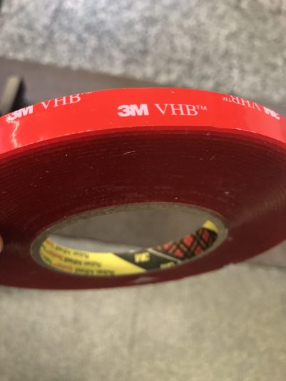

    I have this 3M VHB but to be honest, I’m not impressed by it. It this gummy / silicone- ish clear.
    • Patrick Donaghey
      May 25, 2021 at 7:05 pm
      i wouldnt use that either , i have in the past and it isnt good.

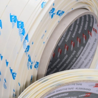

    A great all round tape and one I would suggest trying is Oracals Foam Stick tape.
    It bonds great to an array of surfaces and when it comes to removal. its thick enough for you to put take some fishing line and pull it through between the acrylic and the boat and it will cut through the tape like cheese-wire. then all you have to do is apply and soak it in tar-n-glue remove and it will eat into the tape so you can clean off the residue.

    As long as both surfaces are “high energy”, and clean, I have found the black 3M vhb tape to be just about bulletproof…in all weathers. Never tried the clear stuff.
  • Pane Talev
    June 9, 2021 at 6:50 am
    Thank you all. This worked with the 3M black tape that my neighbour had and borrowed to me. Cheers
