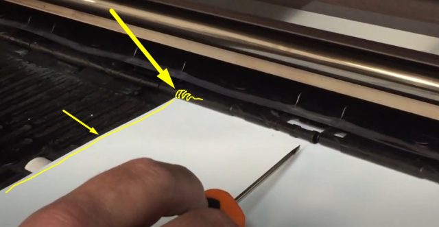

    It sticks to the media pinch rollers on our latex printers and builds up a gluey gunk.
    The attached picture illustrates where the glue builds up on the rollers and the vinyl shrinks back.
    If I go with what I “can see”, then the vinyl has shrunk or curled back slightly exposing the strong adhesive along the edge which tacks onto the rollers and any dust or grime, making it more visible.
