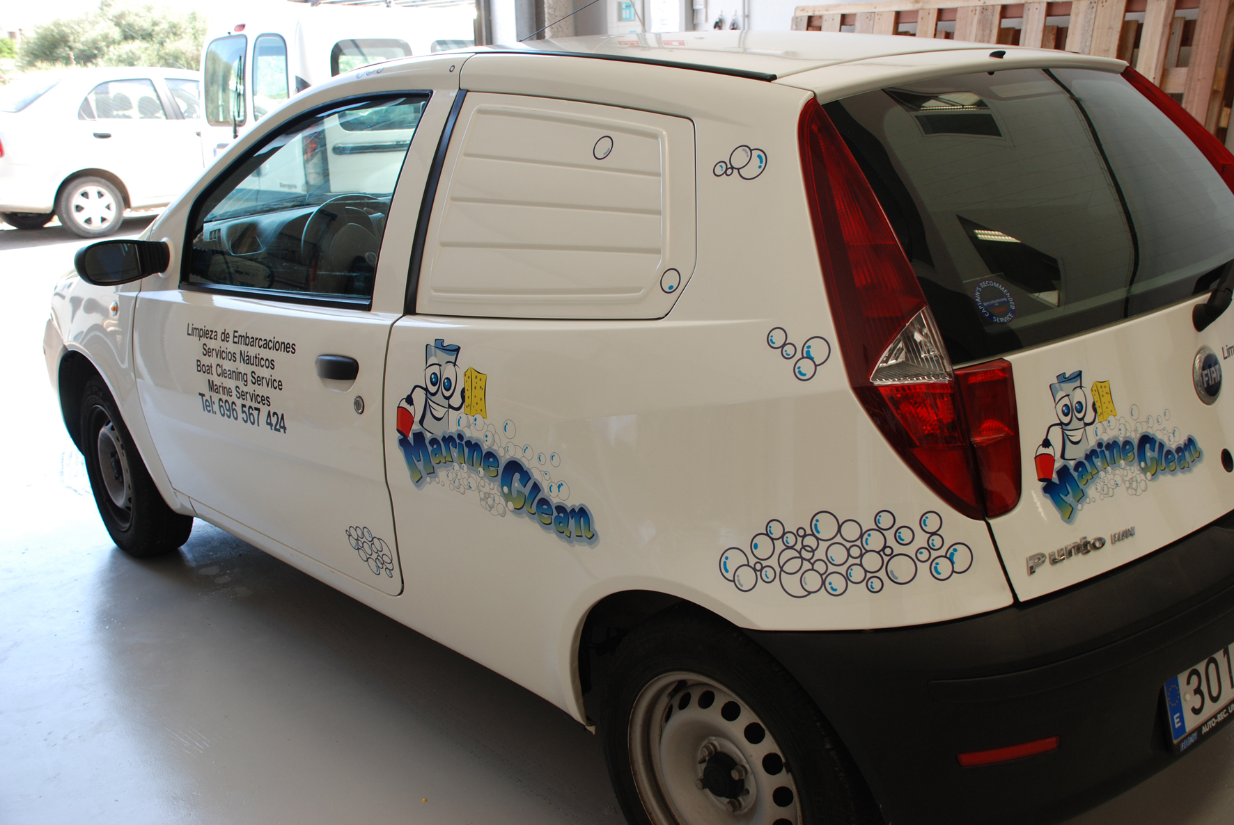

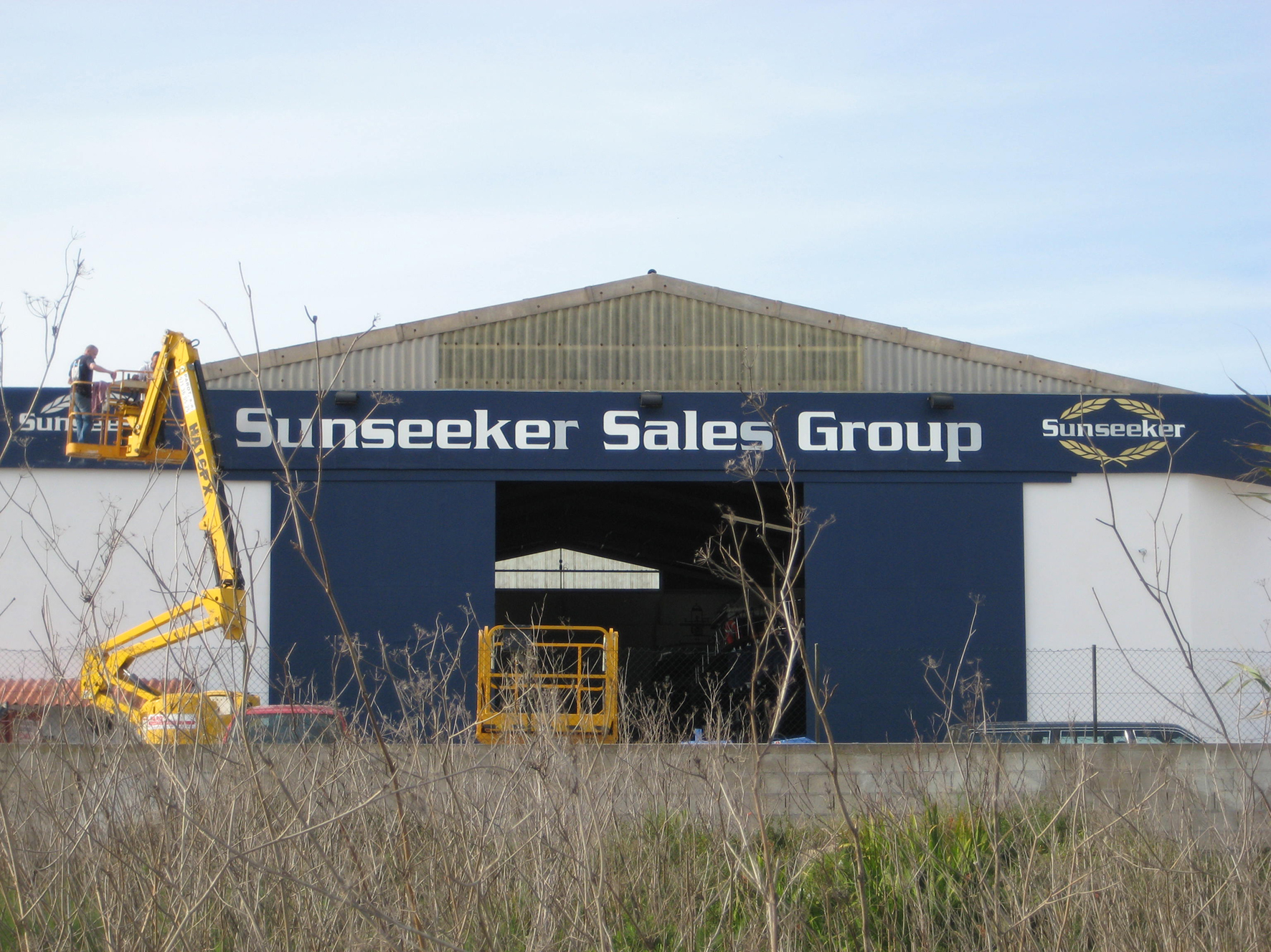

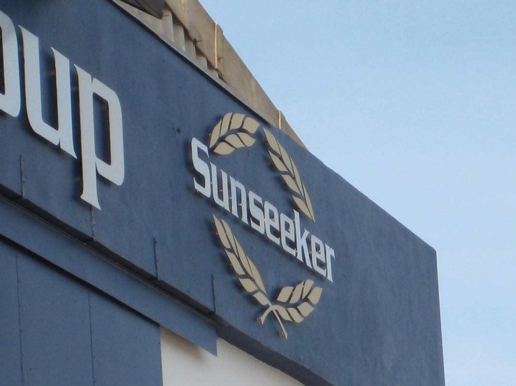

    Hi guys,
    with problems with our printer today, I had a chance to sort out some photos of our recent jobs. here they are. (first time ive posted photos please dont be toooo harsh!!)

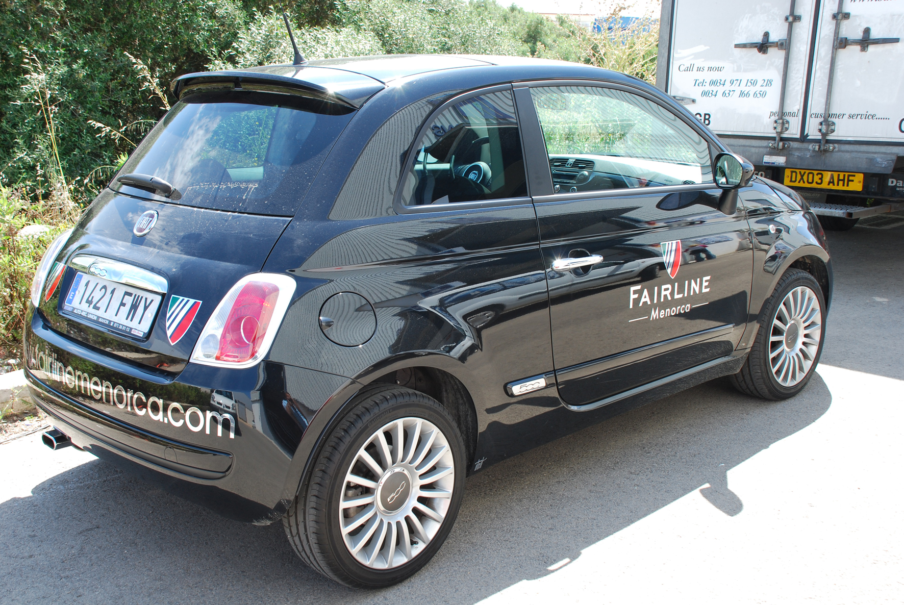

  • Mike Grant
    4 March 2009 at 20:00
    Nice work there Dan.

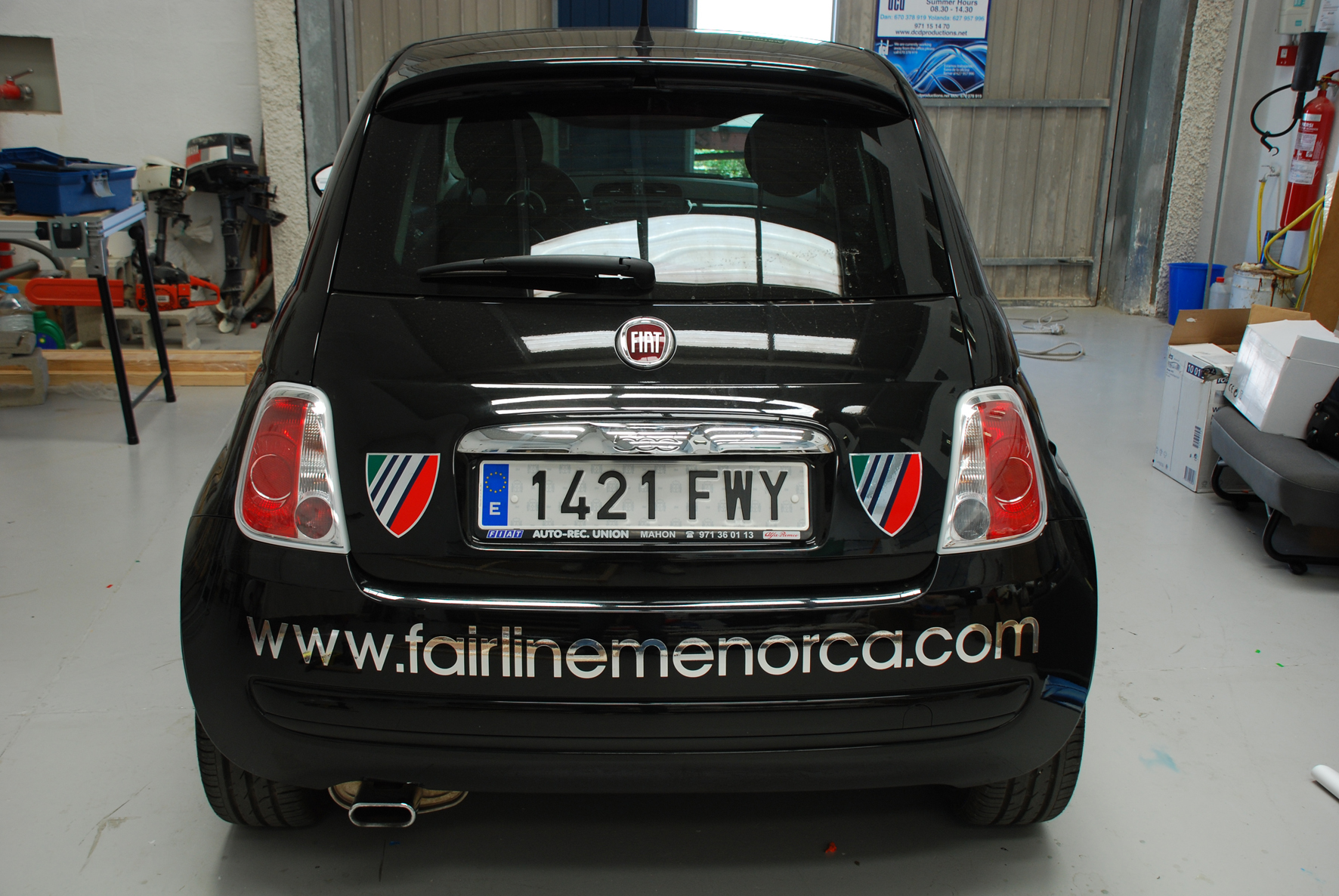

    My only moan is on the Fiats bum, I hate huge phone numbers and web addresses. Looks sooooooo ugggly! 😳

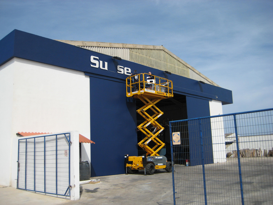

    4 March 2009 at 22:55
    nice work

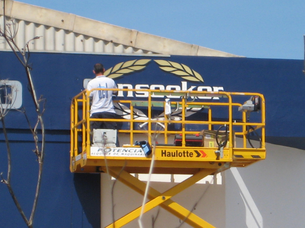

    you must have some guts putting all that Sun seekers on to locators so high up, what sort of customer care did you offer them when or if they fall off.

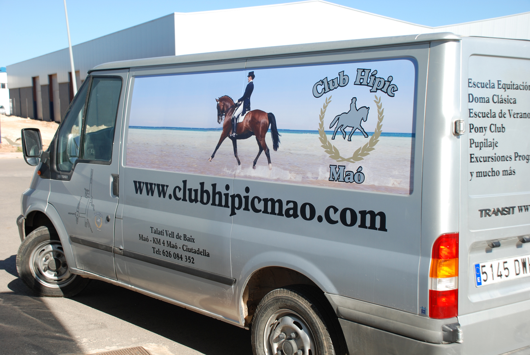

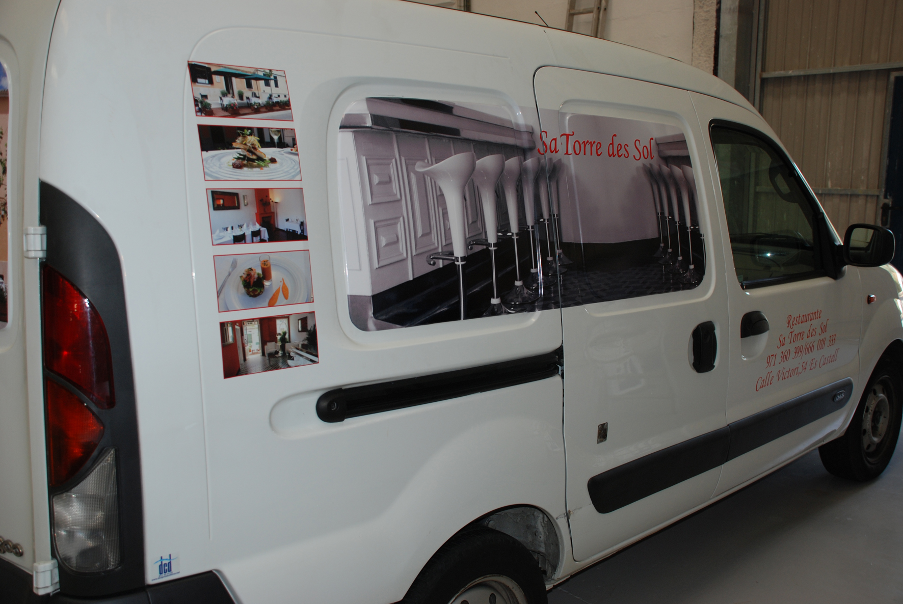

    your Van graphics are cool too, it must be great fitting sign & graphics out in that lovely sunny climate.

  • Dan Osterbery
    5 March 2009 at 08:07
    Thanks guys! for the sunseeker laurels we put two locaters per laurel and superglued the joints.

  • Simon.James
    5 March 2009 at 08:22
    hi Dan
    i never glue locators we always fit the locators loosely, so when all the plastic moves it does not snap the locators of the screw heads.
    we fitted a 24 ft sign on loosely and when we went back 6 months later it was all very tight and rigid, where it had all expanded.
    simon (cardiff)
  • Dan Osterbery
    5 March 2009 at 08:28
    hi simon,
    dont understand, "plastic" these letters were dibond, and the locaters are brass? please explain.
    thanks
    Dan

  • Simon.James
    5 March 2009 at 08:43
    ah very good thinking!
    no plastic to move about .
    cheers
    Simon

  • Martin Oxenham
    5 March 2009 at 12:06
    Dan What he means is snap fix locators.
    In this country people call the nylon snap fix ones locators.
    I’ve been in the trade for 30 Years and I know that proper locators are the brass screw on type, but now they call them all locators.
  • Dan Osterbery
    5 March 2009 at 12:40
    was getting worried they were all going to blow away!! thanks for the explanation!! Have used brass ones before and we havent had any issues.
    thanks for your comments!!
    Dan
