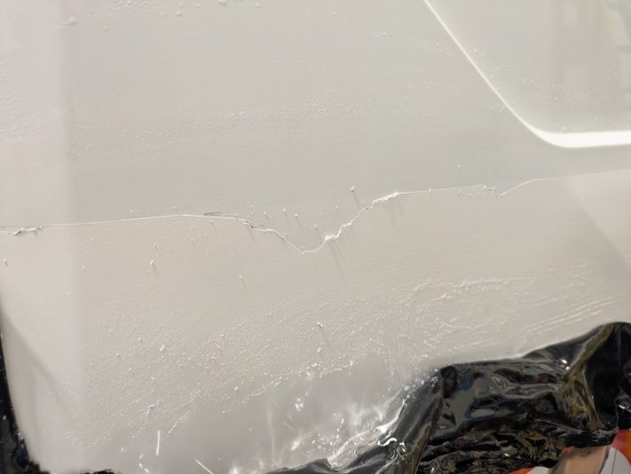

    I’ll keep it short, trying to remove some Arlon SLX installed in 2021/2022, and it’s simply not removing.
    Spoken to a local Arlon accredited installer who says it’s a known issue.
    Any suggestions? The accident repair that was done on Avery has removed fine, but the SLX won’t budge.

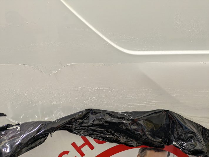

      19 March 2025 at 05:35
      Its not the glue, it’s the vinyl that won’t come away, and just breaks up into tiny pieces.
      Wish it was just glue, but I can’t get to the glue to scrape it.

    22 March 2025 at 19:20
    i thought it was the glue also because there isn’t any ink on it. what is the black part, that cant be the laminate is it?
      22 March 2025 at 20:39
      We’d applied a black stripe along the vehicle, on top of the printed wrap.
      The SLX had a gradient fade, so the black band acted as a break between the wrap and the paintwork along the swage line.
