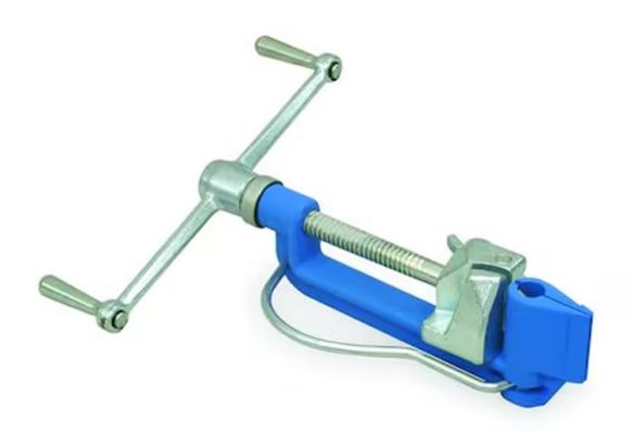

    i have over 50 signs to fit to different diameter size poles and i am trying to find the quickest way to do this without using the old school metal banding crank method. its slow and i never feel convinced that i get it tight enough. these screw bands look much easier but i am struggling to find where to get them?

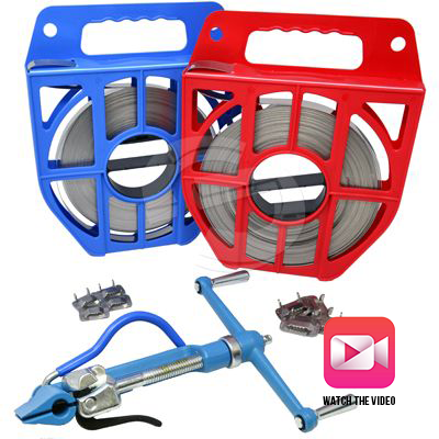

    We also have a banding tool, a reel of stainless steel banding & clips for certain projects.

      i have the banding crank. had it for years mate, i just think its time consuming for a simple process.
      maybe it is because i only use it once in a blue moon. but 50 odd signs with one will be torture. 😫

    I have the banding tool. Bought it around 20 years ago now and like you, I have never been a fan of using them.

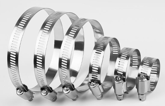

    We have done lots of small traffic and post-mounted signs over the past few years. We use two different types of banding similar to the ones you are showing.
    1, JCS Tamtorgue banding
    http://www.jcshi-torque.co.uk
    2, Righton
    http://www.rightonblackburns.co.uk
    I forget which is which, but you can buy these quick-fixing clamps ready-sized if you have lots of posts and you know the sizes.
    Alternatively, you can also buy a bag of the little cranking mechanisms along with 20+ metres of banding on a roll. you just snip it down to the size you want and fasten the mechanism to tighten it. both are easy to work with.

    try and get one with a star screw head or hex head.
    the type you get for a flathead screwdriver is a pain and beat the purpose of the ease of use.
    There is nothing worse than trying to hold a sign, banding and a cordless gun, at the top of ladders and the head keeps slipping out left and right. 😏

      Will try to find who we bought it from, but we have a long reach tamtorgue driver with sleeve to help reach and tighten at speed, handy tool in the drill box.

    i once borrowed that banding tool from another sign company. i just couldn’t work with it. i could never get it tight enough and there was two of us. 😫
