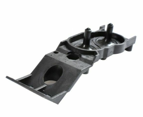

    the pin on the manifold is what the Damper is mounted on, which sits on the head etc.
    If the "Pin" on the manifold splits through wear and tear, or if you do it while changing a damper, it loses suction when the ink is pulled through. could it possibly be something like this?

    If like Robert says the plastic manifold is cracked…it’s a tricky job but totally within most peoples skills if you have some time and a confidence to take it to bits.
    Don’t pull it through…always push through. Always use the damper (as a filter).
    Head re-alignment is tricky to set up if you’ve got to change the manifold.

    To your issue though. Sounds suspiciously like a cracked manifold. Easy to do when pressing the damper onto the spike and difficult to notice. You’ll feel less resistance if it is at fault when you draw ink through the line from the cap. You normally get a new manifold already mounted to the head or you can buy them separately. Could also be a seal not seated correctly on a damper or an air leak somewhere.

    When pressing the damper onto the manifold spike it really is super easy to fracture it and you won’t even know it.
