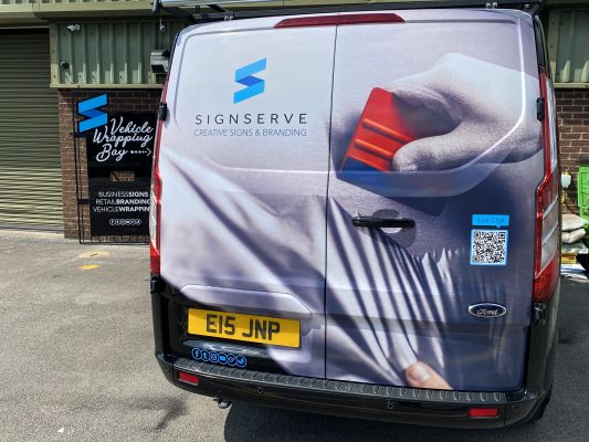

    This the wrap in the back of my van, I think the badges back on this design would not interfere with the design, I have ordered a set of new ones, i am going to give the customers the option of either in a bag or fresh from manufacturer fitted.
  • RobertLambie
    July 4, 2021 at 12:28 pm
    Nice design to promote wrapping, Jamie.
