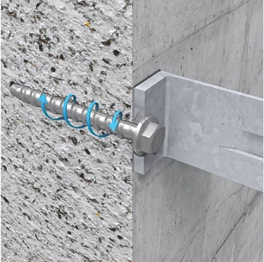

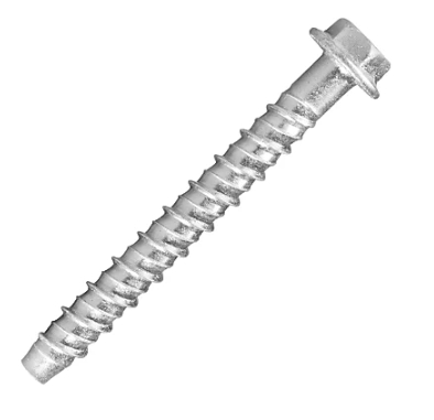

    For a brick or stone surface, a thunderbolt, which is a type of heavy-duty concrete screw, is usually the best option for a repair like this.
    If a concrete screw was initially used but drilled improperly or with too large a drill bit, a possible remedy could be to use a longer or wider concrete screw. This would still require pre-drilling, but the screw should then be able to securely anchor into the stone/brick.

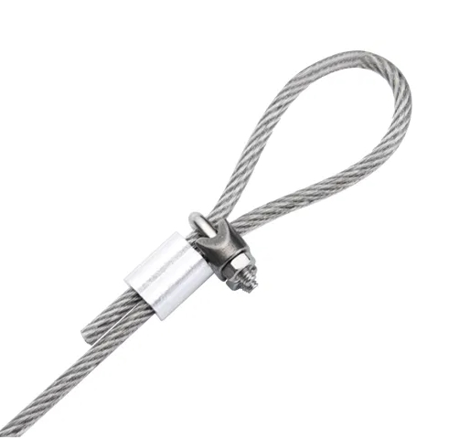

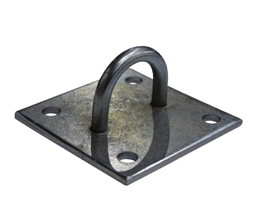

    it is a simple secondary fixing using a U-ring plate and some steel cable.
    fix the plate to the building, loop the steep cable through the loop and then through a drilled hole in the leg of the projecting sign, or wherever is solid. If the sign comes away in high winds, the cable will basically catch it and at least hold it danging until it can be made safe. At the very least, it will catch the sign from hitting passing pedestrians, even if only for a short time until the area is cleared. over-kill? maybe, but I prefer the belt and braces approach and I think it is a good practice to include for potentially hazardous signs.

    i used concrete screws in the end. not the same as the ones shown though.
    in the area the sign was anchored to the wall was much worse for wear, than i could see from the ground.
    i put one screw in at an angle to secure the steel plate and i then drilled a new fresh hole into the plate and fitted a second concrete screw thru that. both with large washers.
    The finish looked pretty rough but the screws held it really well. when i put the second screw in place it started to pull the sign back into place. so much so i had to tighten the first screw more but both had a good grip.
    i told the customer that he will need to have the sign looked at properly and that what i had done is only a temporary fix.
