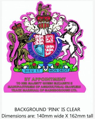

    Hi folks again,
    this is for my ‘old school’ printing process again…
    It’s often a problem when the finished ‘sticker’ has to go onto a Clear vinyl to allow the background where it’s going onto, to show through (i.e.) the colour of the surface..
    But, there is a way apparently to print a White backing first in just the colour area so that the surface it’s going onto doesn’t distort the colour or change it.
    It needs to be ideally in a Gerber Omega file (.plt) but I do think I would be able to work in an AI file.
    Could & would anybody have knowledge of this, I believe it has to do with ‘layers’ some folk often use Corel or Illustrator to do it.
    If I supplied the artwork would anyone be interested in doing this for me at all, or even just explain how it’s done, please??
    Regards,
    Titch Sanders

  • Dave Sanders
    14 February 2025 at 11:40
    This is the image, but I have many others that need this process sorting.
    Titch
  • Dave Sanders
    14 February 2025 at 13:09
    Or maybe this file is easier to open…..all ‘Pink’ is CLEAR
    Titch
  • George Zerbino
    15 February 2025 at 08:32
    Hi Dave,
    What version of composer do you want, and are you printing the colour in CMYK or do you want the gold to be a separate spot colour?
    Regards, George
  • Dave Sanders
    15 February 2025 at 08:40
    Hello George,
    It’s Omega 5 that I use and all colours are spot colours ideally, but happy to use CYMK if need… but Spot Colours always give a brighter result.. I believe that ‘Underbase’ is the terminology too??
    Regards,
  • George Zerbino
    15 February 2025 at 09:11
    Hi Dave,
    Here it is as composer 5, using spot colours.
    In gspplot make sure you tick the “global prime” box in print options (keyboard shortcut is F11, or setup/print options on the menu).
    Regards, George

    ….helps if I actually attach the file 🙂
    rename the file from .doc to .plt for it to work – I can’t upload a .plt file here

  • George Zerbino
    15 February 2025 at 09:33
    The spot colour all have a “primer” option ticked on them within composer, so when they are printed the edge will ask for a white foil to print before the colour.
    The global prime option in gsp plot ensures that you only put down one single primer before all of the spot colours – without it the edge will ask for the white foil before each spot colour!
  • Dave Sanders
    15 February 2025 at 09:39
    Hi George,
    OK thanks, just looked and using F11 yes, it shows a White print first, then 9 or 10 other White foil to be used.. do I put all in order so that I don’t need to print any White’s again?
  • Dave Sanders
    15 February 2025 at 10:17
    I see it thank you, Global Prime.. I’ll try that thank you George…

    This is looking ‘Tremendously’ good thank you George!!
