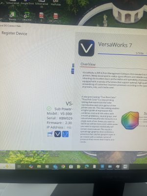

    Hi guys
    I’ve recently purchased a used Roland VS300i printer. I’m having real difficulties connecting it to my PC. I’ve read the manual, watched every available YouTube video 😫
    Does anybody know anyone that I could pay to assist, perhaps remotely (access my PC)?
    Many thanks
    Nick

      I had to download Versaworks, but I didn’t get very far because when registering- Roland couldn’t find my printer in the network. So, I haven’t even downloaded Versaworks yet!😫
      It’s driving me crazy to be honest
      Thank you, though
    June 19, 2025 at 3:48 pm
    The printer will need to be on the same subnet, and IP range as your router/pc network.
    If you open windows command prompt and enter the command ipconfig it will tell you most of the information there, similar to the below:
    IPv4 Address. . . . . . . . . . . : 192.168.100.150
    Subnet Mask . . . . . . . . . . . : 255.255.255.0
    Default Gateway . . . . . . . . . : 192.168.100.1
    Your printer will need to be the same address group (192.168.100.XXX)
    Subnet and gateway the same.
    I suspect this may be the issue.
  • Nick Minnery
    June 19, 2025 at 4:14 pm
    David, thank you. Do the last 3 figures (where you have put XXX) need to be different to the PC’s numbers?
    I think they do, just checking. I’ll try again
    Thanks again
      June 19, 2025 at 5:14 pm
      Yes they need be unique, so no to clash with any other devices on the network.
      You may be able to log into your router and see what IP’s are being used.
  • Nick Minnery
    June 19, 2025 at 5:30 pm
    It worked!! Not sure what was incorrect originally, but did exactly what you said, and it found my printer straight away!
    What a relief, thank you again David 👌
