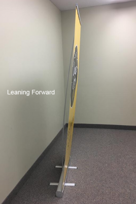

    October 23, 2024 at 1:38 am
    I’m sure I have seen people using normal banner film.
    Quick answer for this…
    I would not use normal banner material unless it is only going to be used for one day!
    The banner material will begin to curl in on itself down each side over a period of about 24 hours or so.
    If there is a lot of ink coverage, this may happen much faster.
    Depending on the grade/weight of the banner and the stand base quality/weight, the stand may begin to lean forward or backward quickly, if not over a period of hours.
    Do not get me wrong, budget or faulty stands can lean forward or back, but a lightweight base and a heavy material tend to increase the problem.
    The attached picture is not one of my stands. I am just using it for reference.
