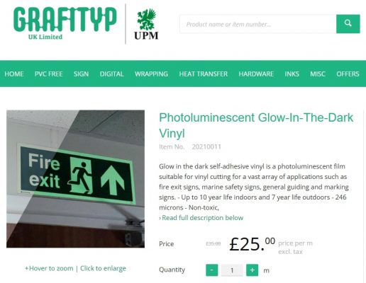

    We buy FG600 from Grafityp, but it’s very expensive.
    It has 20 years of indoor life and 7 years of outdoor life.
    So if you are quoting against another company, make sure that it’s a like-for-like quote.
    Tried a few others, but none were comparable. It is printable, but a bit fiddly – you need to use a lot of heat, and a high pass rate, otherwise, you are likely to get fisheyes in the print. The alternative is to print on clear vinyl and mount this to the photoluminescent.
    https://www.grafityp.co.uk

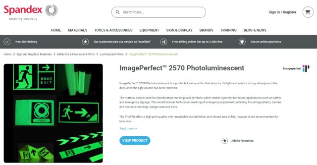

    I use ImagePerfect 2570 from Spandex, much shorter life than the one Jamie mentioned, though (5 years unprinted according to the data sheet!)
    Not had too much trouble printing it, we’ve run about 15 rolls this year, but they’re only 10 metres long and used a generic polymeric profile at 16 passes on our SC80600.
    https://shop.spandex.com

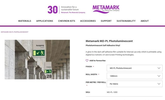

    We use Metamark’s offering and have tried pretty much all of them over the years as we supply a lot of safety signage. They’re all a bit of a pain on short runs from our experience, as the thickness of the vinyl can separate from the backing sheet and scuff. Even when stored correctly. Long runs are much better. We find the final metre to be a write-off a lot of the time, as it is coiled so tightly.
    As mentioned above.
    It’s very pricey. We’ve missed out on work previously, only to a competitor has printed the job on reflective, not Photoluminescent.
    https://www.metamark.co.uk
