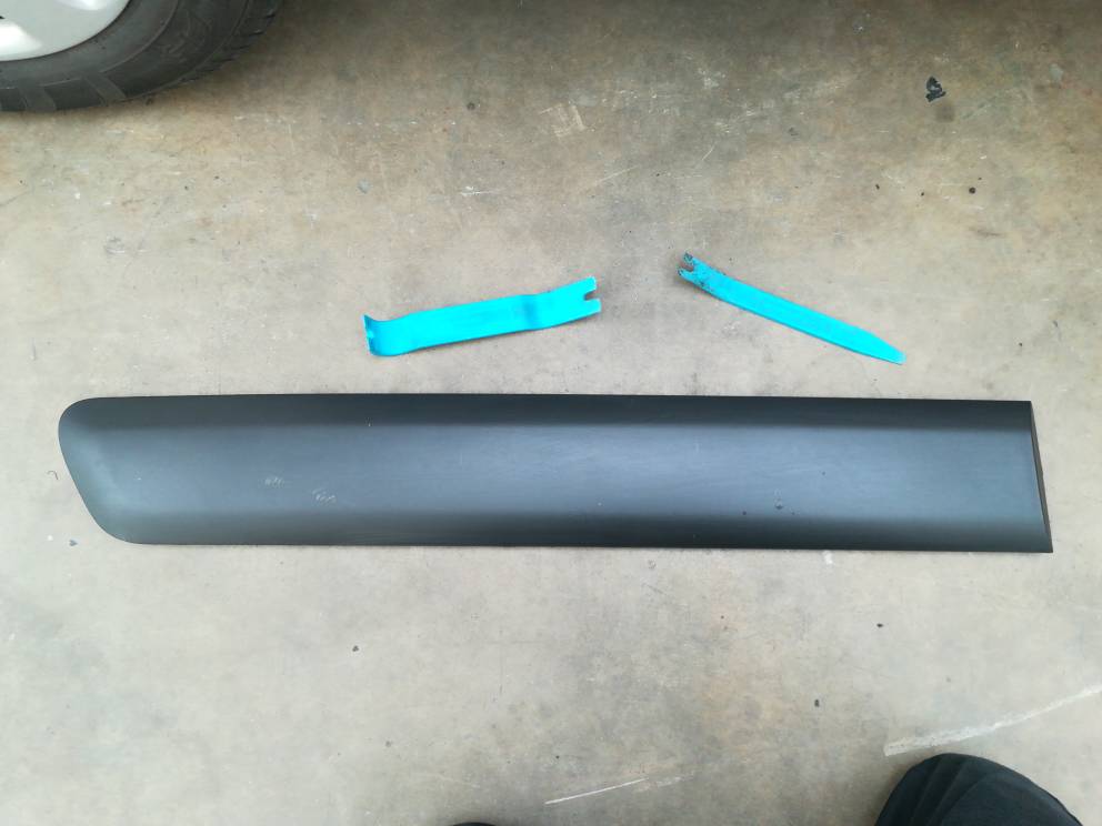

    It’s been mentioned previously about how to remove certain types of side mouldings. We’d a Peugeot Partner in for a half wrap yesterday so I thought I’d take a few pics of were the clips are for the side mouldings. Gently pulled it away from the body starting at the side of the door which allowed me to see where the 1st clip was. Used some moulding tools to lever them off making sure I had it inserted between the body and clip rather than between the clip and moulding (if that makes any sense).

    Very in depth, It’s always good to keep these clips in stock as those clips do become brittle.

    Totally agree about then going brittle. Last time I managed to break 11 out of 14 taking them off! Thankfully we’re surrounded with car dealers and a motor factor’s so spares are easily got [emoji846]

    Missed your post, thanks for sharing David, always hand for others to be able to actually see pictures rather than read a description. It is also handy for anyone that is involved in doing vehicle graphics to have the plastic trim and mould levers shown in your pictures.
