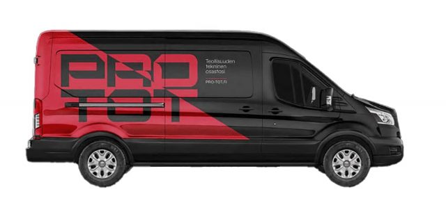

    Hi guys,
    I’ve had this “proof” come through from a designer.
    I need to give a quote for the job, but not 100% sure which way to tackle it. The actual van to be done is a LWB new connect, not the transit in the proof.
    – 1st as usual there is just a pantone colour, so not sure if its just printed or i colour match as close to wrap film as possible.
    As to doing the job, which method would you do-
    -Just print as it is as one with text
    – print the red, fit, then lay the black text over the top
    – closest colour match wrap film, with cut of letters fitted as one
    – Closest wrap film, lay the red then cut text over the top.
    The back also has full red coverage with a logo in the middle.
    My natural feeling, whether its printed or from the swatch, is to lay the red as one and cut text over the to,p but just want to make sure I’m not being too cautious.
    Also, how much time would you allow for the job, 1 day or a day and a half?

    16 March 2025 at 08:07
    Looks a bit of a faff, don’t underestimate the time.
    You could lay the red a solid band, the. Overlay the black, then apply the red text at the right (the R & O bits) a separate piece too.
    Cutting the text out of the red and wrapping, you’re going to need to tape the vinyl, and it will distort to some extent, overlaying you could feed it in.
    • Martyn
      16 March 2025 at 12:20
      This is exactly what i was thinking. Also agree with the faff statement. Would you agree with pushing them towards a solid vinyl match rather than print?

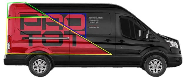

    17 March 2025 at 02:10
    As David says, cutting the wedge of solid Red, would be an easy option.
    But the gloss black you lay on top might not be as shiny as the vehicle body, but would still do the job.
    However, cutting it as it is and fitting it, will require taping it up and being careful of the tape removal to the areas of vinyl that you need to stretch into the recesses. Even then, you will get some slight distortion of the vinyl where it has been stretched.
    It is a bit of a trade-off though, depending on the size of the van, you may have to have a cut in the wedge, to make it work. If you cannot get the wedge in one full section, it might be better to do it in two sections, but lose the “panel join” within the cut text. doing this means…
    * You hide/minimise a panel join.
    * You still get the nice gloss black from the vehicle making up the text.
    * You reduce the amount of vinyl used, as you do not need to overlay black text on 3 sides of the vehicle.
    Choose the installation option that you feel most confident with and manufacture the graphics to allow you to do that.
    Do not get hung up on colour matching, just say you have a range of eds for them to choose from.
    Below shows some panel options for cutting the graphic in three sections. Yellow, Blue, Green.
