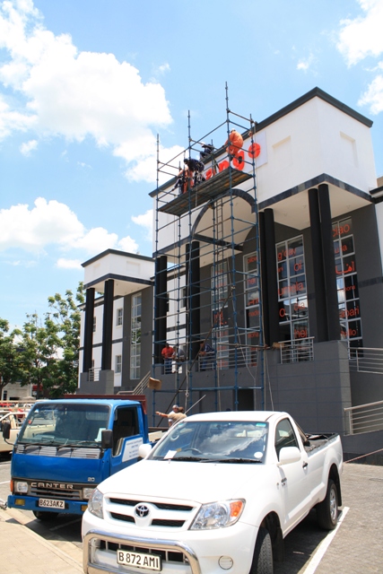

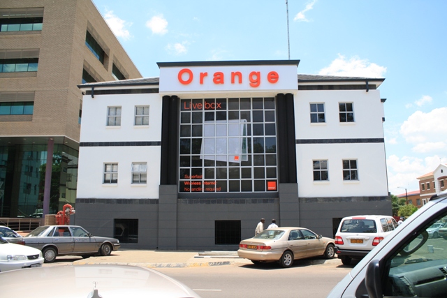

    Hi Just did this job for the new head office thats just opened.
    36degrees outside it was a scourcher. Completely naked ready to go home and have an ice cold one.
    We did various internal branding as well.

    Nice job…..
    but you are making me jealous with the weather !
    Its freezing in Scotland.
    If I want to wear shorts, I have to go to an indoor heated swimming pool… 🙂
    5 December 2008 at 09:16
    looks very nice Dane… what are the letters made from mate? are they a fluorescent acrylic or aluminum built-ups sprayed? just asking because of the great weather you have there im wondering how UIV stable the colour will be?
    nice job to get and even nicer customer to have under your belt… well done and thanks for taking the time to post your work…
    on a side note, might just be the picture angle and the capital letter and lower case g scenario, but is it straight? its probably my eyes mate… im mr mcgoo on a good day. 😳

    Well all I can say is that you have good eyes. The bottom of the parapit wall has been plastered skew by the builder it is 40mm out so we have made the sign straight with the top and have suggested to client that we get a builder on site to re plaster the wall. Well done for picking that up. 🙂
    The box is made from powdercoated alluminium and the letters entirely from translucent orange Perspex. Forex backing boards and single tube neon.
    Thanks for the comments.
