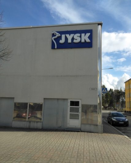

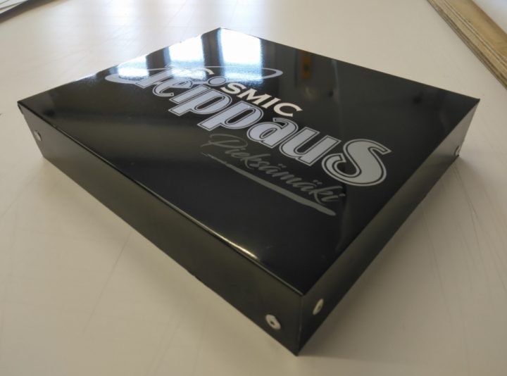

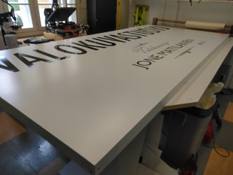

So since running on my own (13 yrs) I haven’t made or installed a tray sign. However previous to this when I was employed I have fitted a few. Anyway, I decided last month to try and produce one with a hand router, used brackets for corners. I think it turned out pretty well. So I decided to push it a little and have sold the idea to a new shop I’m doing. Just wanted to run through the job with you and would be grateful for any feedback. So it’s going 5m up underneath the jysk sign. Wall is concrete. Going to use a scissor lift but not sure about basket size or extension as yet. Was going to make it from one sheet of 3mm Dibond 1500*3000. 50mm aluminium angle top and bottom (not sure on brown plugs or anchor fixings?) As I always work alone thought the tray would be much easier to fit instead of a panel, as long as the basket is big enough.So really my concerns are: are screws and plugs acceptable for the angle or would you use anchor fixings, and is this size of the tray a good idea? Or is going to joining 2 at 1500mm a better idea.
