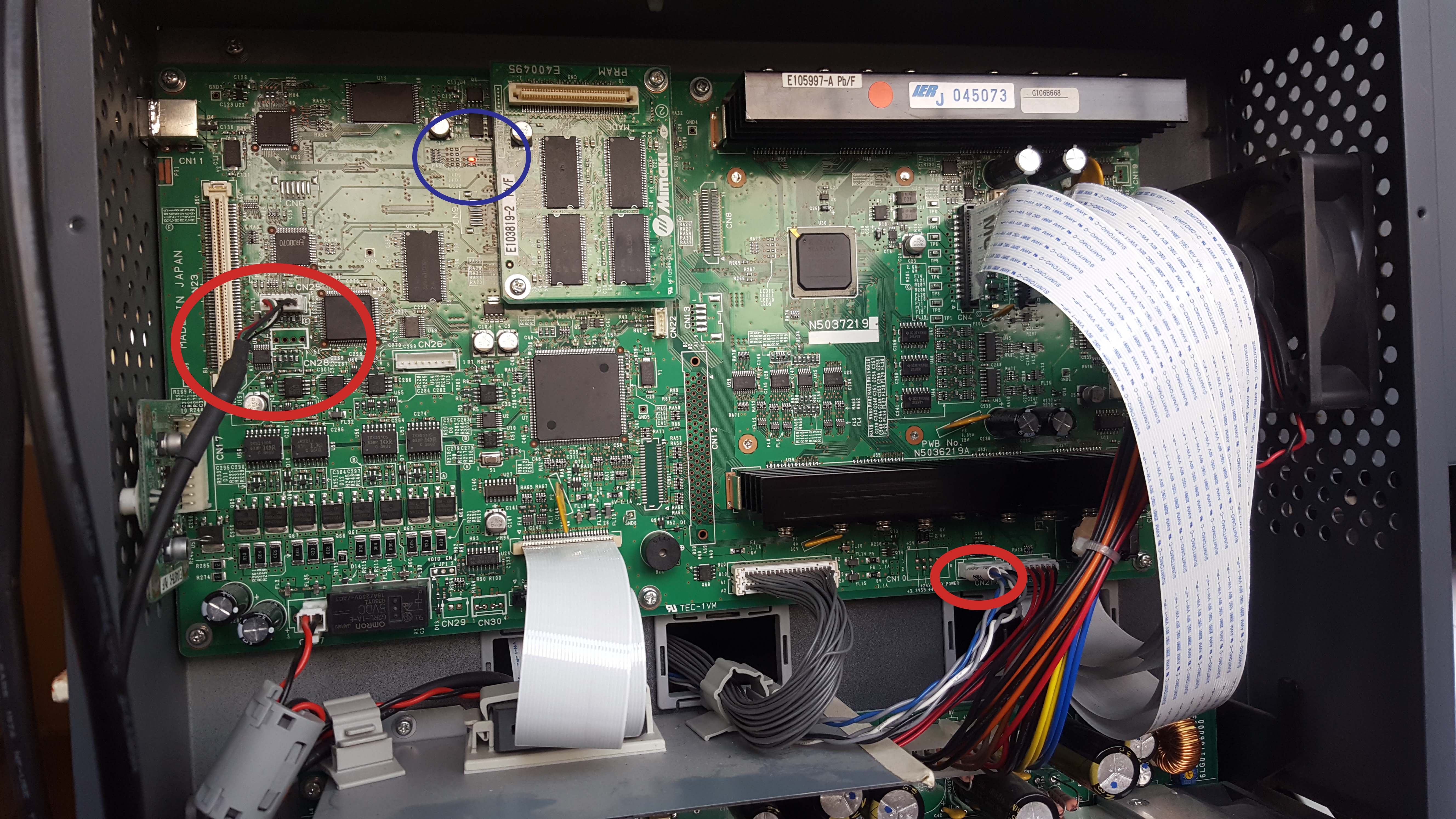

    Hi Guys,
    I seem to have a problem with my USB communication between my Mimaki JV33-160 and desktop PC. I have tried several things but still seem to be in the same position. I’ve tried the below:
    1. tested 2 – 3 new cables but no joy
    2. tried 2 – 3 different desktop/laptops
    3. scanned device manager after disconnecting/connecting cable
    4. restarted PC and rebooted printer
    5. removed driver for mimaki and re-installed
    6. tried installing driver/rip on another machine but the they just do not pick up the printer at all
    Having done all of these things Hybrid suggested it could be the main board because all other avenues had been explored. Therefore, i removed the main board and set it off to repair to a company called’industrial electronic repairs’ on the advice of an engineer i know who has used them previously to repair a board. There web add is http://www.ieruk.com
    Upon receiving the board i installed it but unfortunately i’m still in the same position!!! FYI, they replaced the USB socket which was corroded according to them and i think they did some soldering and tidy up work.
    The one thing i did notice is that LED 3 is lit up red at the top centre of the board. I’m uncertain if this was the case previously because i didn’t check.
    I’m running out of ideas?
    The engineer suggested i check the power supply board to see if it is pushing power through all of the cables attached to the board. I’m no electrician but baught my self a beeping tester and a clamp meter. I’ve ATTACHED an IMAGE for your reference. The two cables highlighted in RED don’t give me a power reading using a clamp that i’m using. And the BLUE circle highlights the LED 3 that shows up red indicating an alert. I have attached an image of the clamp i purchased also. I can’t say with any conviction that i am convinced that the power supply board is the problem?? Because i’m no expert. These cables have many strands/mini cables that make up the complete cable so i’m uncertain whether the clamp would always give a reading??? Saying that all the cables gave me some power readings.
    Any help would be desperately appreciated!!!
    I’m £520 down so far and have been over a week without my printer!
    Thanks.
    Fraz

    I’m sorry to say but I had this very same problem on my CJV-30.
    Bought a new main board from digiprint supplies (just over £700) and all soughted…..eventually!
    I did take it to an electronics company to see if they could repair it but unless they had an actual machine to build up around it they said there was no way of testing/fault finding the problem…..but we can only go by what the professionals tell us right?
    Good luck with getting it soughted, I know how you feel.

    JV33 mainboards suffer from USB problems more than any other fault. I have 4 or 5 of these in our warehouse. All of which have USB faults, all of which have been sent away for repair (including to IER), all have come back with USB faults and all will be used for nothing more than diagnosing tools forever more.
    I know hind sight is a wonderful thing, but you could have paid for half of the new mainboard you need by now.
    Sorry to be the bearer of bad news.
    Stafford

    Like you said hindsight is a wonderful thing. But hearing that you know of boards that have still failed after USB repairs suggests to me that a new board is the way forward.
    James @ Group101 mentioned that you’d be the guy to talk to about these sorts of issues but he didn’t have your contact details to hand.
    A great thanks for your input most appreciated :o)

    I’ve ordered a new main board for digi print supplies and it should arrive tomorrow. But i’m guessing i have to somehow configure the new board to recognise my printer? Does anybody have any step by step instructions? is it pretty straightforward?
    Thanks.
  • Stafford Cox Stafford Cox
    June 2, 2016 at 9:16 am
    No problem.
    It’s not difficult as such, certainly not difficult to fit physically, but without the USB port working on the old mainboard you will have to acquire a similar parameter file from somewhere and upload it, or configure the board from scratch.
    I can’t urge you enough to get an engineer in to fit and configure the mainboard.
    Stafford
