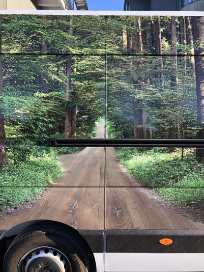

Posted by Pane Talev on April 24, 2021 at 6:27 amMetamark MDX.
The only thing I can think off is that this was done during the big freeze.
I was feeding the vinyl in.

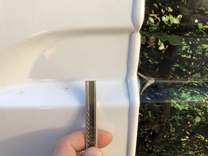

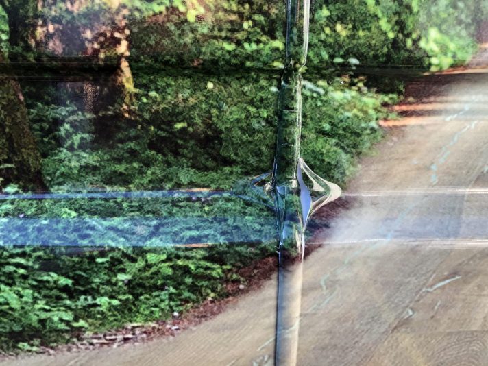

I was hoping the vinyl is going strong into the recess, but because of the cold indoor workshop temperature, maybe the vinyl didn’t kiss the deep recess of the van.
The silicone joins are so big, that pressure points are just to strong, and it failed.
Moral is down.
How do I improve on this?

There are a million reasons for a wrap to fail, outgassing, cleaning, overstretching etc. but those vans are a MASSIVE ask for a polymeric vinyl. Feeding into a recess is no guarantee with recesses as deep as those, especially when so close to a flexible joint like that. I would say as said in another recent thread with a similar problem, that your material selection was wrong.
These manufacturers are dangling carrots with these hybrids. If they could do the job, Avery, 3M & Arlon would be out of business. Don’t beat yourself up over it, you were mis sold on the vinyl.
Remember this (your supplier will deny responsibility) the next time your rep is trying to offload a new & improved version of this vinyl onto you. The responsibility ALWAYS ends up at your door. Always over specify your vinyl

As Kevin mentioned this product is sold as a wrap film and may work well on a Volkswagen Beetle but when it comes to commercial vehicles stick with a true cast
MDX is marketed as a Cylinder Cast (they made this name up) its either a calendared vinyl or it’s a cast vinyl. You’ve used a Polymeric film that will shrink and in your case break.
For commercial vehicles stick with a true cast, fit it correctly and you should have no comebacks
