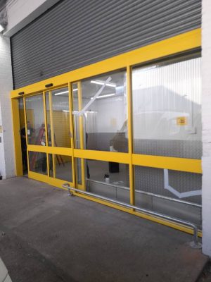

    Do these doors require manifsatation under DDA. I didn’t think so due to them not being full glass and having the horizontal bar through them. Would just fitting dots at the higher level (1400 -1600mm) be accepted?
    TIA

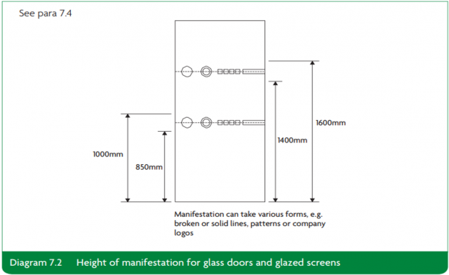

    So yeah, I’d say bottom yellow bar splitting the glazing complies with DDA, so only higher level required.
    solid bands, decorative features, or split bands of 50mm allowed.

      So are we saying second row is required?
  • RobertLambie
    August 24, 2024 at 5:38 pm
    I would say yes, Iain.
    I agree that it looks pretty obvious there is a construction/door there, due to the yellow band of the door. but I imagine this is geared up for the worst-case scenario and all it takes is someone tall focusing straight ahead and they will miss the yellow band, and BANG! “should have gone to spec savers”. 😏😆

    yeh, i think it is based on “in-line of sight” an adult or kid walking into the glass. so you have two levels of dots needed for safety. we did a a bunch of doors in a health centre and that’s what i was told.
