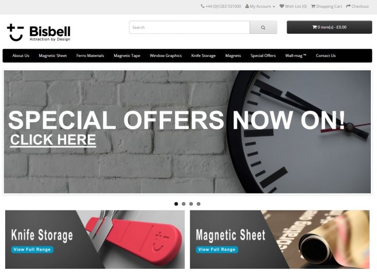

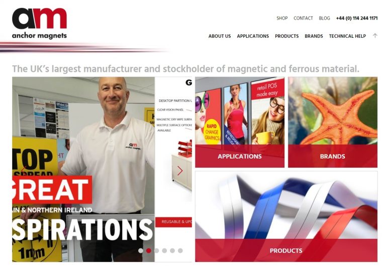

    You should try contacting Anchor Magnets or Bisbell Magnets. I have used them over the years.
    You would need a digital surface grade to print directly to the magnet. I have never used it though, I normally just mount the vinyl to the face of the magnet.
    I doubt you will need a magnetic the same strength as you would use on a vehicle if putting them on a fridge.
    https://www.bisbellmagnets.com
    https://www.anchormagnets.com

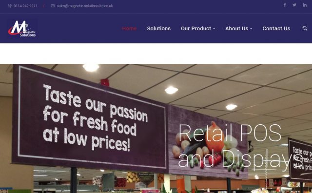

    We use Magnetic Solutions http://www.magnetic-solutions-ltd.co.uk as well as Anchor Magnets.
    I’ve never had much success printing onto the thicker versions (0.6/0.8mm), so apply vinyl to them but the thinner grade (0.3mm), which from memory they call ferrous paper prints fine.
    I’ve cut this in our Graphtec but not all the way through, just on a pressure heavy enough to score the surface giving you a good guide to get a blade into.

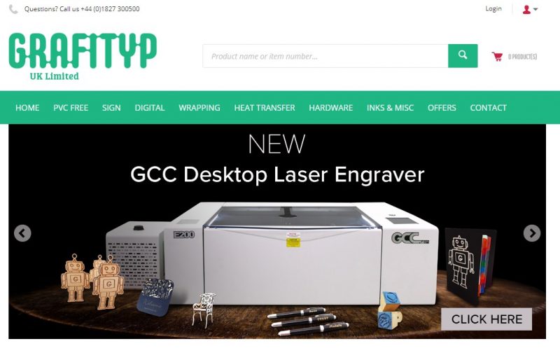

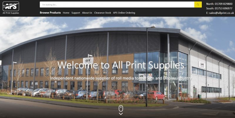

    I am sure Grafityp and All Print Supplies do a printable grade magnetic material.
    https://www.grafityp.co.uk
    https://allprint.co.uk

    Danny I used to put the thinner magnetic rolls from Bisbell through the Roland in my previous job and it printed and cut fine. I used to just keep a separate blade for magnet cutting and put the force on full. It would rarely go all the way through, but it would cut deep enough that you could then push the cut shapes out the roll. It’s probably not the best treatment for your printer, but it worked.
