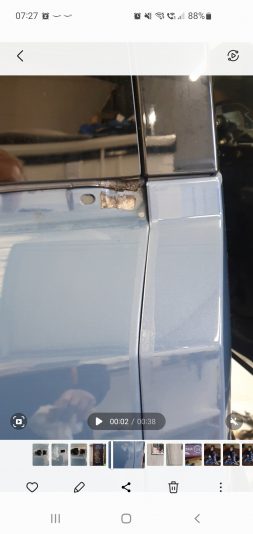

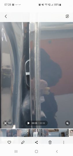

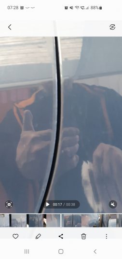

    Wow, have I had a frustrating couple of days.
    Job in this week for a repeat customer, good guy.
    He has just purchased a Landrover Defender for his wife and want’s it wrapped for her birthday this weekend. They had fallen in love with the new wrap from the Yanni-dude. Pink Tutu, Pearlescent. New from Avery.
    OK with that exept that the vehicle was already wrapped in Avery Supreme colour flow.
    Because of the time factor it was agreed that the customer would remove the wrap over the weekend.
    I didn’t have a problem with that, it being Avery, shouldn’t leave much “gluage”. I had looked at the wrap when they brought it in last week and had to admit that it looked like a well-done wrap.

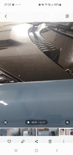

    Anyhoo, he brought it in yesterday having removed all of the vinyl but there was still “a bit of glue”.
    OMG!!!
    Whoever had wrapped it before had used Primer 94, literally everywhere!
    Now, I have it in my arsenal but I rarely use it.
    Perhaps a rusty spot on an old van that I’m concerned about, or under a front bumper maybe, or under a sill.
    No – these guys literally slavered it on with a one inch paint brush.
    Not only that but on the edge and inside EVERY panel. I’m not kidding. Around the whole vehicle, even the door handles, inside the petrol flap, the wings where they meet the bonnet – absolutely everywhere. They even coated the door handles in it before they wrapped them.
    I’ve spent the best part of two days removing it, now I have one day to complete the wrap.
    Sorry for the negative nature of this post but I wondered if any of you guys have had a similar experience with this bl**dy stuff. Aught to have a licence to use it!!
    Timmo
    PS I will post pictures of the wrap when it’s done, it really is a very nice colour – if you like pink that is.

    nothing worse mate. 😏 i stripped some digital prints off a van. it was just a part wrap and nothing OTT. but they had used primer or something in the deep channels on the side of the van. the rest was easy, but the time it took to clean the channels was unreal. after about an hour and not making much progress i had to call my customer. lucky for me he accepted billing him for a few hours extra, so i cracked on.
    what did you use to get rid of it?
  • Tim Hobbs
    10 December 2024 at 21:55
    My go to is Autoglym, Tar Spot and Glue remover. I had to scrub some though!

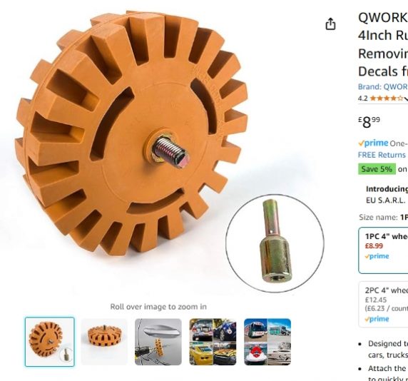

    However, one of the best things for removing stubborn-caked adhesive is a simple “toffee wheel”.
    I have several types of toffee wheels in my box, from the tractor tyre type, stepped rubber, and thin rubber discs, to the standard Caramac coloured 15mm smooth type shown in the picture.
    you can get these on eBay, amazon etc but I buy them from a local spray paint supplier in my industrial estate or even Halfords if you are stuck. I am sure it was Halfords that bought the tractor tyre type. but I prefer the standard smooth one.
    Anyway, the standard smooth one in a cordless is best for this, in my opinion.
    Don’t spin it at high speed, just keep it flat on the wheel and rock it back and forth. it should take it clean off.

    Thanks Rob. I’ll have a look at those.
    I tend to use that Autoglym stuff and those orange plastic razor blades, the ones that have the same hardness as a finger nail.
    Photos below.
    Did you add those photos to my first post BTW? Yes. That’s the stuff. It is really quite a nice colour. I do like Pearlescents though. I’ll post some photos when it’s done.

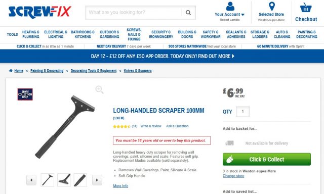

      For windows and glue, a brand new 4” stainless scraper blade and scrape away with loads of soapy water, off in a flash!
      • Mark Johnston
        11 December 2024 at 20:03
        do you mean a wallpaper scraper or a razor blade?
        • Craig Thompson
          12 December 2024 at 09:11
          Like this, new stainless blade as if the blade gets a nick that’s what will scratch the glass.
          https://www.screwfix.com
          • Mark Johnston
            12 December 2024 at 09:40
            handy! i havent used one of those before. i have few smaller blade scrapers.
            thanks buddy.

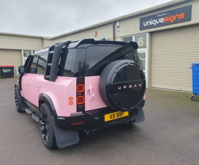

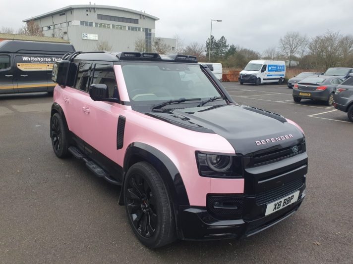

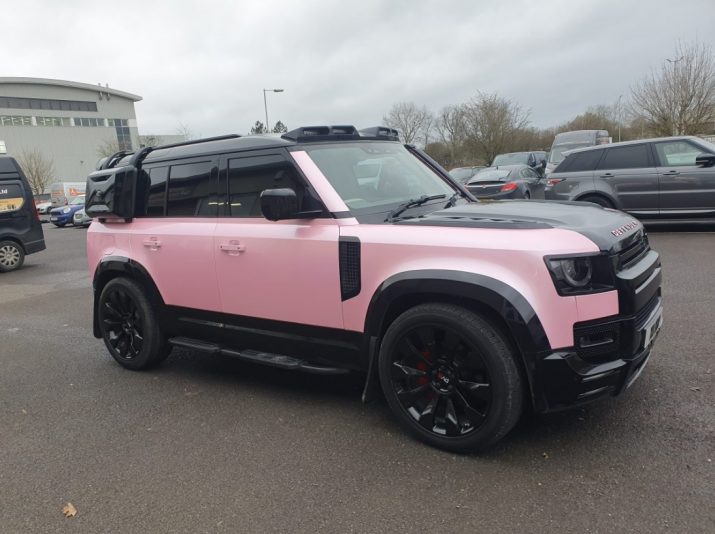

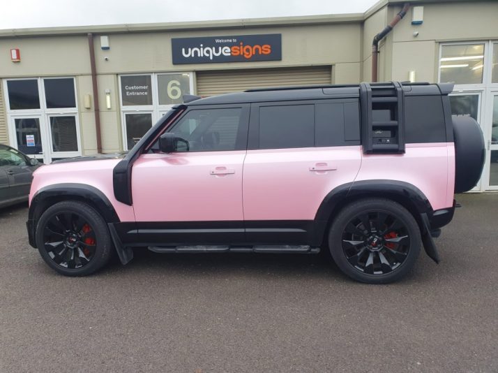

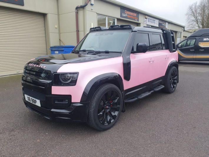

    Here are the pictures of the finished job.
    24 December 2024 at 20:44
    That was NOT what I was expecting! 🤔
    It looks great Tim. Very smart mate! 👍
    I do not know what I was expecting, as I was following the post, I think “in my head”, I had a typical Landrover (don’t ask me why).
    I also had the pale blue paintwork with the primer all over it and I think I had already thought, with the pink wrap, this is might look tacky, but it does not!
    I think the pink coverage is just right to feminise it but minimal enough for it not to look like something Kate Price drives.
    Anyway, it looks great! 😎
    Thanks for taking the time to post the finished job, Tim. Great work, as always mate.

      I used the Autoglym Tar and Glue remover in the end.
      I also used several of those sponges with the hard plastic on one side.
      Not generally recommended. However, the customer was aware of the whole process. The car will need a good machine detailing if and when the wrap comes off but that was the compromise with getting it done in time. It did slightly “mist” the edges but the 3m primer had already caused some damage in that respect so it was the best option.
