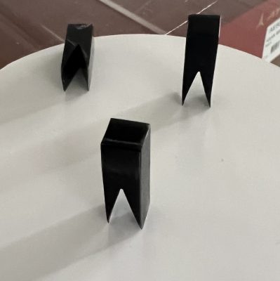

    Getting bounce back, so the laser it almost cutting twice on way back up also. We get round this by putting small off-cuts of acrylic underneath so almost floating the peice you’re cutting up 5mm and this solves it for us??

    I guess you are just starting up using the laser David? Too much power + raise the cutting piece. I almost never use the honeycomb bed.

      Had a little play this afternoon with some success. Raising the material helped and as you say I think I had the power much too high!
