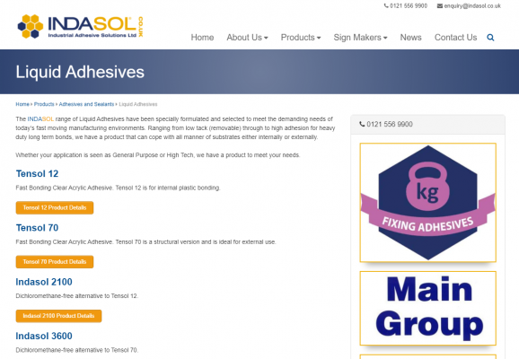

Tensol is your best bet – Indasol sell it, external one is Tesol 70, you need to mix it in small application bottle but when it drys it is totally clear and solid.

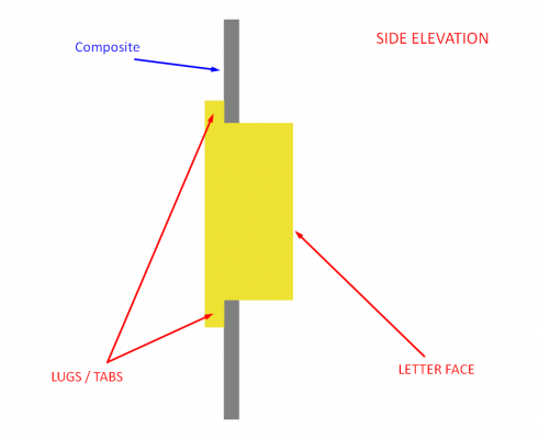

So you squirt the clear adhesive on the opal and stick it to the clear. the trouble is it creates a shadow of the shape of the adhesive between the two plastics?You could router the letters but create a step/lug all the way around the letter when routering it, so when you push it through the step/lug catches and holds the letter in place.
