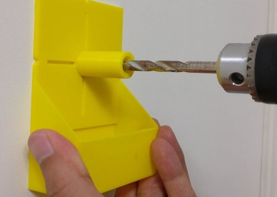

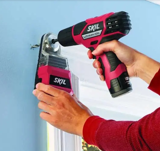

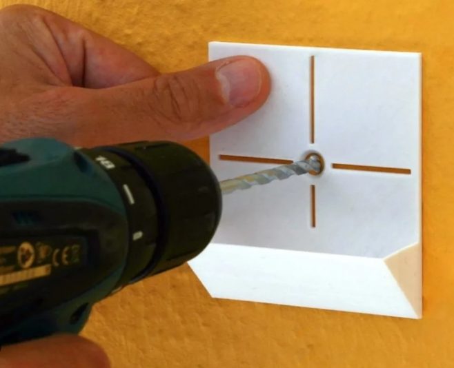

    this works surprisingly well

      September 26, 2024 at 7:42 am
      thats cool idea!

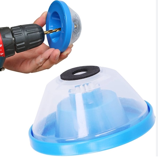

    I was hoping that i could plug something on to my drill but i am not having any luck.
    the ones i did find were additions to large masonry guns costing a couple of hundred quid for the dust catcher.

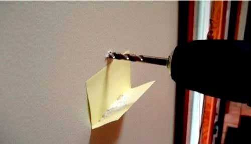

    When doing indoor office type signs, I often use an envelope with a bit of masking tape.
    This works great and catches pretty much everything. However, the downside of this is that every so often, the masking tape can lift a bit of paint from emulsioned walls that haven’t been painted very well.
    Your suggestion of a folded Post-it is very good because the adhesive is very minimal but enough to get the job done! I think it would work great for plasterboard walls, but I think if the walls are brick, the chips of concrete and dust are a bit more extreme and will land out with the post-it area or would be too heavy for it.
    I’ve always used the envelope or even and few bits of masking tape to create a little cradle to drill above and the waste to fall into.
