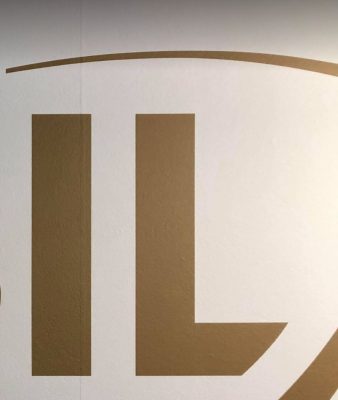

    I need to put some graphics on a wall. Wall is rough. Normal vinyl doesn’t work, doesn’t stick.
    We tested high tack and works fine.
    Do you know of a high tack gold?

    Hi Peter / Martyn. Yes, client decided to go for full wall wrap and I printed the job.

      @Jeff-Rea. I matched the gold with clients printed stationery.

    @pane-talev1
    That’s a nice shade Pane.
    I am more meaning the finish of the colour like a metallic gold finish. rather than a colour shade. if you see what i mean? I cant help but see it as a flat colour rather than a metalic finish of a gold or silver. I mean when i try printing it for customers. maybe i am being over critical of my own work.
