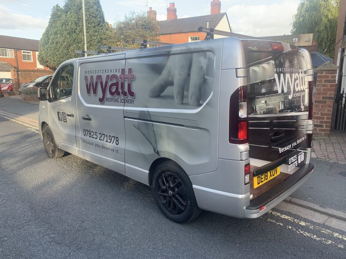

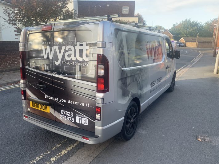

    i love the Wyatt van wrap, it is really smart.

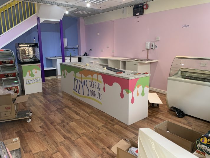

    i also really like the counter wrap. you have gave me a great idea for a customer i have just now. thank you! ❤

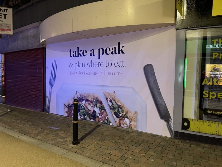

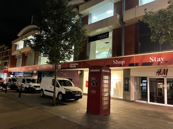

    The cathedral square job, are those pans or flex face or?
    I agree with Leslie, the Wyatt van is very nice.

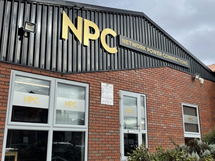

    It is good to see those big flat cut letters installed properly and without “rails” at the back, on that cladding. especially the wide cladding straps like those which are a pain at the best of times. my pet hate on any signs is “rails”.

    Just a vinyl print over an existing steel run of trays for cathedral square, a race against the rain, the shop fitters at next, the light & the traffic wardens. 50 metres long, & surrounded by the public walking around without looking up from their phones. The purge will be great fun

    always enjoy seeing your work Kevin! Is that a clear wrap on the wyatt van?
    • Kevin Mahoney
      October 29, 2021 at 6:01 am
      Clear polymeric with relief cuts on the sides, with Avery 1105 on the back doors on that one Hugh
        October 29, 2021 at 8:36 am
        I had to go back and look again… I like that! I’ve used clear on sliver / white many times for silly accreditation logos or things I don’t have vectors for / can’t be arsed to cut out, but I don’t think I’ve ever thought of doing large panels in poly. Works really well!
        • Kevin Mahoney
          October 29, 2021 at 8:46 am
          I do a fair bit of these for the tight arses who don’t want to stump up for a wrap, generally make a vignette out of the image & take it right out to the edge of the panel rather than leave an edge in the middle of a panel, gives a kind of airbrushed look

        Relief cut? Where’s that?
        • Kevin Mahoney
          November 3, 2021 at 3:23 pm
          Just a cut where we know the vinyl will definitely fail, like a single step recess

    (agree with Rob on the NPC letters, much better without rail))

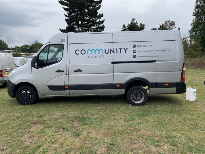

    loving that community logo, felt tip fairy job (as you would say) or one of yours?
    • Kevin Mahoney
      October 29, 2021 at 8:26 am
      design agency job Martin, over a hundred of those done, had to strip & clean the old on off first, felt like I lived there for a while
      • Martin Cole
        October 29, 2021 at 2:30 pm
        Jeez, that a lot of vans.. to strip aswell
        • Kevin Mahoney
          October 29, 2021 at 4:24 pm
          They called today to say they’ve found another 10, guess I’m moving back in again
