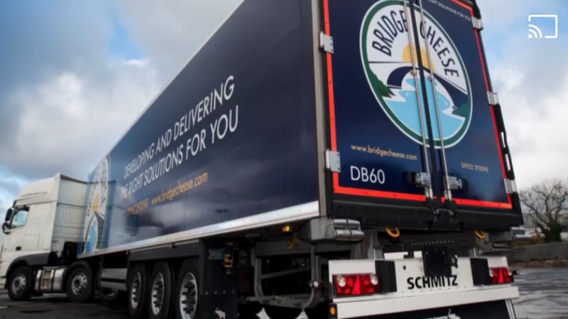

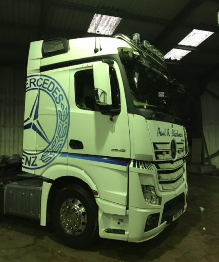

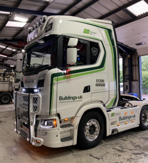

    Nice work as always Kevin, always enjoy seeing your stuff.
    Was the Tractor Unit done with knifeless tape, or cut on the plotter?
  • Kevin Mahoney
    July 24, 2021 at 1:57 pm
    Thanks mate, we do those lorries as print & cuts on clear.
    Really fast installation.
  • Martyn Heath
    Interesting, never seen this done on clear before but as you say installation must be simple.
    I always assumed the vehicle outlines would not be spot on enough to match up but obviously, they are.
    What clear did you use Kev?
  • Kevin Mahoney
    July 24, 2021 at 1:58 pm
    Image perfect on that mate, never use vehicle outline libraries either, just a photo with a ruler & magnets works perfectly
  • RobertLambie
    July 24, 2021 at 2:15 pm
    Always good seeing what you have been up to Kev, nice one mate. 👍

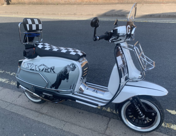

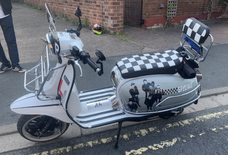

    Have to say, I would never have thought about printing the truck graphics onto clear for those lines. I am not sure how it would compare like-for-like to cut vinyl, but on multiple vehicles, it is a great idea and would really speed up the installation process even with one or more.
    Looks like you have made a good job of the lines to the body shape too, nice one!
    As you say, scaled up photos are often the best way to create your own template.
    I think the whole Vespa scene seems to be coming back. we have had at least 3 requests for wrapping parts of them in the past few months. It hasn’t been worth our while due to the severe dome shape and time it would take to wrap them, but doing it like you have in print and cut graphics would have been a much better option for them but they don’t want to listen. 😏
    all great work, thanks for sharing mate.
  • Kevin Mahoney
    July 24, 2021 at 2:29 pm
    The Scooter side panels were wrapped Rob, just the lorry graphics were print & cut. We do quite a few fleets like that, generally uses a couple of metres per lorry for the kit, around an hour for a 1 man install

      I can see it’s wrapped now mate, completely overlooked that. nice one!
      The last guy that came in wanted a colour matched candy apple metallic red with a target printed into it. then wrapped over a severe domed shape. probably similar to where you have the graphics on yours, but his a boxier shape but still domed, curved. hard to explain.
      I could have printed onto a metallic cast white but I’m then buying in specific media.
      I then have to do the colour matching trial and error process.
      You then have the wrap to apply. and keep in mind this is a “round target”. if it went on spot-on, sure as sh1t the target circle will distort with the heavy stretching.
      I hate jobs that all the way through the process i am thinking if he doesn’t get perfection, he is not paying me!
      I ended up just sending him to one of my mates who does traditional signwriting and air-brushing, and is excellent at it. as I gave him the details he muttered… “thanks mate, but these air brush guys charge a fortune!”. 🤨 😏 🤣

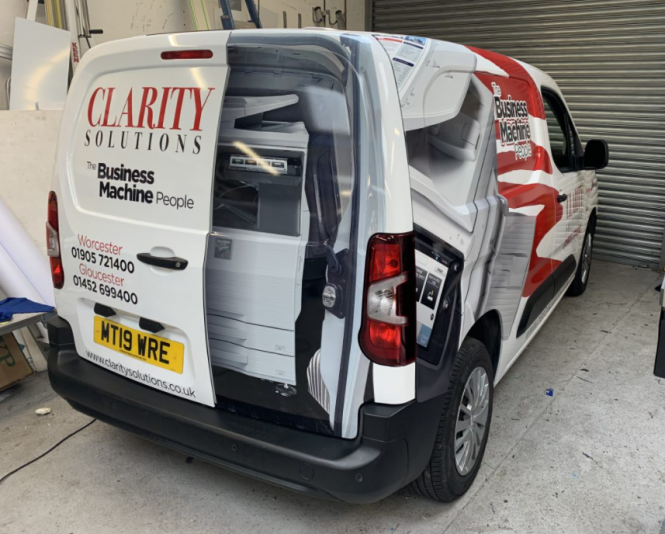

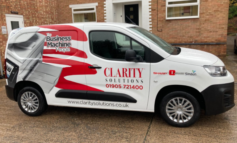

  • Martin Cole
    July 28, 2021 at 10:09 am
    Great stuff Kev, all top draw work as usual.
    Very inspirational along with great design and application as Rob mentioned

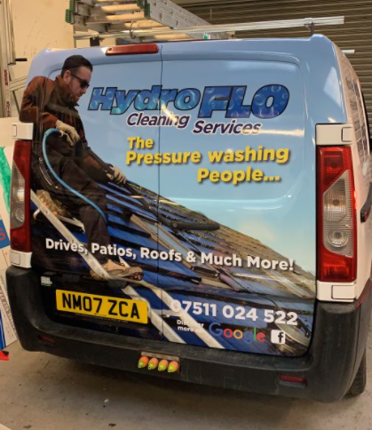

    Love the ‘business Machine People’ van👍
    • Kevin Mahoney
      July 28, 2021 at 10:31 am
      Thanks Martin. I actually bought that machine printed into the design on the back door so I guess it must be working for them😀
