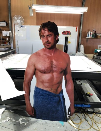

      A life size cut out of Rob!
        November 22, 2020 at 10:53 am
        I think rob would still look up at this one,😆 without his heels on……
          November 22, 2020 at 8:18 pm
          😂😂 I’m saying nothing without my lawyer present!

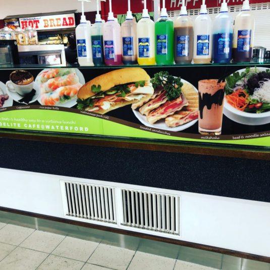

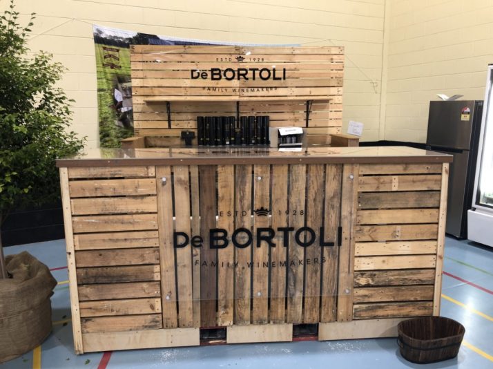

    All great work Shane. In particular, I like the desk fronts. I really like lettering and logos against background surfaces like stone, wood etc. Very popular these days too. 👍

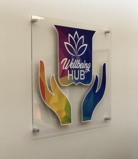

    The Wellbeing one on the clear acrylic. Is that mounted to the face or rear?
    I did something like that not long ago but had to print to clear and back it in white vinyl and mount on the rear.
    November 26, 2020 at 1:56 am
    Yeah we printed on the face too. Just easier at the time but I could have done it either way. We had a lot of stickers to print for their doors as well so it was just easier to do them all on the same print run. Client didn’t care either way.

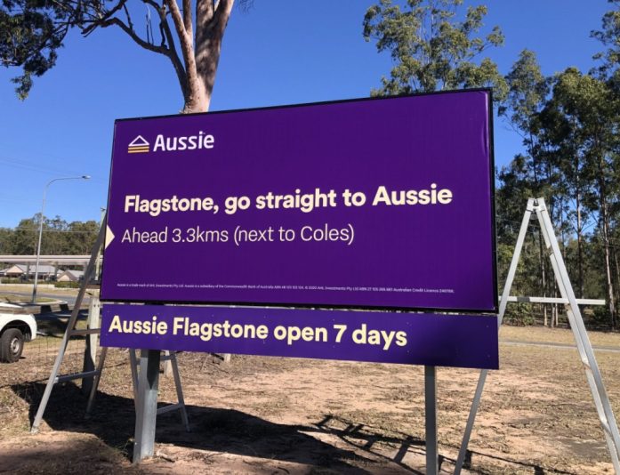

    What frame system have you used on the purple Aussie Flagstone sign? Looks (from my phone screen!) like some sort of flex face?
    Pretty substantial ground frame too!
      December 5, 2020 at 11:58 am
      It’s just a sail track banner system. Timber frame, sail track bolted to the frame, and the corresponding cord sewn into the banner. Simple, cheap and easy to install, as long as the frame is solid.
