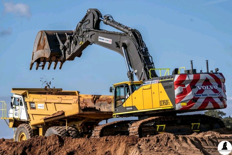

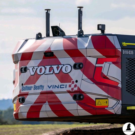

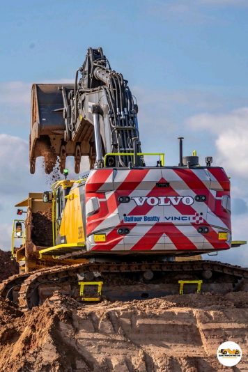

I have attached some pictures of the rear of a machine done as a kit. (this is not one of my machines)
You will see it is completely done as a pieced kit, which is certainly a clever way to do it, but these will have been created from a 3D hand scanner or someone digitising the rear from photos etc. which takes a hell of a lot of time to get right! but worth it if doing loads of vehicles.
