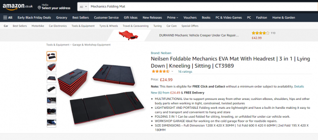

    we have small trolley seats for fitting vinyls and also flip-out foam mats for lying down. both work great and are cheap as chips. if I was going to invest in something more geared around vehicle wrapping I would invest in a hydraulic lift rather than resurfacing my whole work flood.

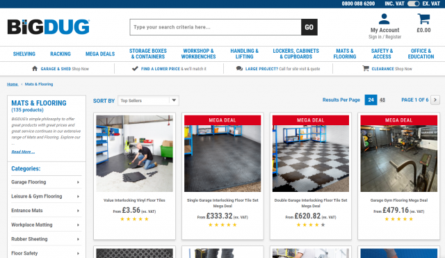

    We have the heavy duty, interlocking floor tiles from BigDug.
    https://www.bigdug.co.uk
    Been down years, gets used daily, and no issues. Only damage sustained is where I dropped the bar off the laminator onto it, and punched a hole in a tile. Just don’t get chequer plate ones, as your wrap stools don’t roll as easily on them, and it’s harder to keep clean.

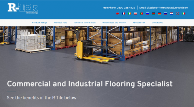

    http://www.r-tekmanufacturingltd.com
    We’ve just moved premises but took ours up and refitted at our new place even though years old and with vans, forklifts going over them daily. Perhaps not the cheapest option but worth it.

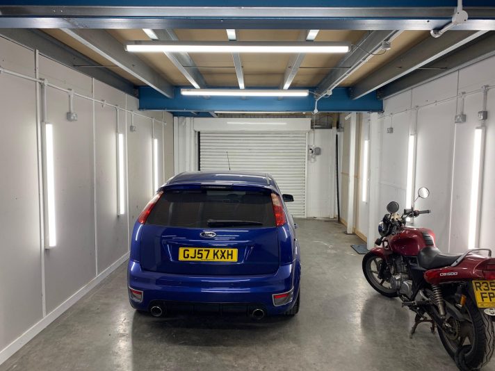

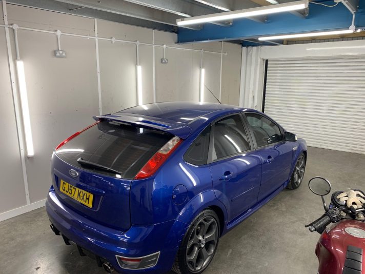

    Bit of an update.. we’re now in the swing of refurbing / expanding the unit(s), building a dedicated wrap ‘clean-room’. Electrician has been in while we’ve been on hols and rewired the place, new sockets and LED lighting throughout – lighting is switchable on either side, just awaiting the Ecotile rubber floor and to build the new wall to finish this bay, then we can start on the larger bay. A little more tricky as there is about 1800kg of mezzanine to take out, to allow for vans over mwb, to a height of up to 3.75 mtrs!
    Will update as more happens!

    September 29, 2021 at 12:00 am
    the room looks brilliant. well done Hugh!
    now, I bet you wonder how you managed to get by from your shed? 😀👍
    thanks for coming back to update the thread mate, makes all the difference seeing the end results.
      September 29, 2021 at 6:50 pm
      My timber studio down the garden? They’re all the rage now, I do believe I was ahead of the game 🤣
      This new workspace will be awesome when it’s done. It’s primarily so I have a more professional looking space for wrapping, we’re on a busy main road which is usually chogged with bored yummy mummies in their Q7’s that need wrapping! We’re going to push for that market but, to offer the premium service, we need premium looking premises!
  • Kevin Mahoney
    September 29, 2021 at 5:10 am
    That looks bang on Hugh, good work. Very few people understand the thrill of putting together a new workshop. God help the first person to throw a scrap of vinyl on the floor

    September 29, 2021 at 8:22 am
    Looks great Hugh, you’ll enjoy working in there

  • David Stevenson
    October 4, 2021 at 7:47 pm
    Now that’s the job for sure. Well lit, lots of sockets, dust free, and a Focus ST too! Is the ST yours or just visiting?
      October 4, 2021 at 9:59 pm
      It’s the landlords ST, it was hiding in the unit when I punched through the wall into next door, I let him have it back! He has a 400hp RS ST too, not my cup of tea but it’s scary fast, without all the whizz poppety pop pop bang farty noises the yoof seem to like on their corsas these days 🤣

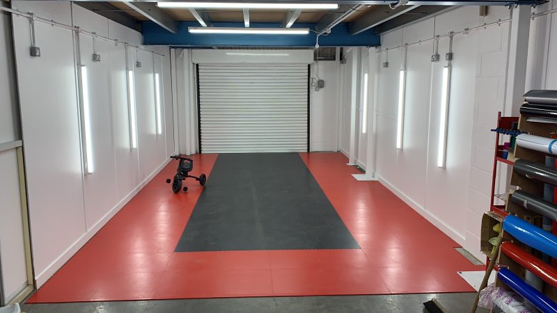

    I’ve had the floor down a few weeks now, such a huge improvement. Not only aesthetically, but more comfortable to kneel on, warmer, and easy to clean without bits of paint getting stuck in the broom or mop!! When the other bay is properly finished – around 16m2 of mezzanine and steels need coming out to open it fully for large vehicles, I’ll update again!
  • Kevin Mahoney
    November 8, 2021 at 11:21 am
    Looks fantastic Hugh. Hopefully moving soon, definitely nicking this idea
      November 8, 2021 at 11:40 am
      It’s well worth it! I put black tiles in the middle as the manufacturer said that if you leave cars on it for length periods, the rubber compounds from tyres/tiles can mix and discolour, so this was everything parks on the black and, typically does so straight!

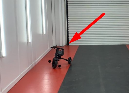

    The bike reminds me of ‘the Shining’ for some reason
      November 9, 2021 at 2:28 pm
      ha, me too, especially when the daughter was testing the new floor!

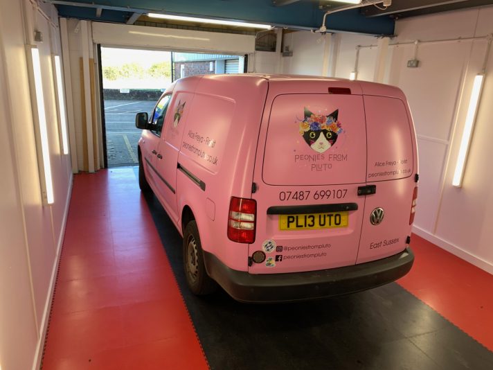

    sorry, meant to ask.
    are the tiles hard foam or plastic?
    if foam, how do they perform when turning tight on them? by that i mean if you put the front wheels on full-lock, does it tear at the foam?
      November 11, 2021 at 7:12 pm
      Hi Rob,
      I used Ecotile rubber flooring tiles, a hard wearing rubber, a finished surface a little like an old hammerite paint finish, easy to clean and pretty hard, though much nicer to kneel on than concrete.
      I haven’t tried turning a wheel on them, I don’t want to try it as, while I don’t think it would damage an individual tile, it may pull at joints etc.

    November 11, 2021 at 8:50 pm
    Yeah, I can imagine it be excellent for installing on.
    I use one of these fold-out thick pad matts, all the time makes life so much easier.
