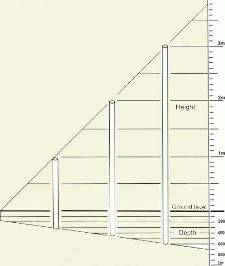

    This has worked for me in the past, obviously just a guide.
    Sign channel applied to back of sign with UHB tape with primer & rivets.
    Lay panel on the floor (if you can) and attach posts to the sign channel then you have your hole measures,
    dig holes same depth / width as you need, offer sign up, if level get concrete or post mix in and square up, if you feel you need riggers install these after.
    Hope this makes sense.

    Exactly as craig has described. The only thing i would add is hole depth, i always go 1ft in the ground for every 3ft out the ground

    Craig’s illustration gives you a good starters guide to the depth.
    Make sure you do not dig a narrow hole or a hole that tapers in like an upside-down cone at the bottom.
    Do your best to keep the hole about 18 inches in diameter all the way down.

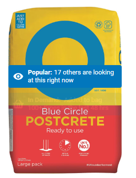

    For just general freestanding sign work, the likes of Postcrete is fine as a quick solution to a premixed bag of concrete to secure the post.
    Personally, prefer to mix my own with sand, stones, cement and water because you get a good heavy strong fixing. As I said though, the post create will do you fine.
    A well-dug hole going down about 600-700mm will require 3-4 bags of postcrete each.
    You may use slightly less, but you can return it or keep it for another job. but definitely better to have too much or too little. Do not be tempted to backfill on top with soil to save a bit. it does not secure the sign properly and may lean back after strong wind or pushed back by kids.

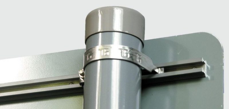

    * x4no. channel rails on the rear.
    * x8no. 76mm clips
    * x2no. 76mm Galvanised steel posts
    * x2no. 76mm plastic caps

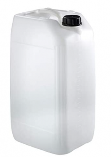

    * x2no. plastic water drums that hole 25 litres of water.

    Or, if you do not want to buy all the elements to make the sign. Just buy it pre-made at the size you need, from Righton. Complete with posts and caps. All you have to do is apply the graphics and install the sign.

    Postcrete:
    Do a quick Youtube search for how to use postcrete.
    It is very simple, but you must follow the process or the post fixing will not set as it should.

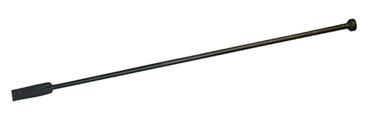

    Pinch bar:
    I cant advise stronger on the use of a decent steel digging pinch bar at approx 1700mm long.
    One digs with the bar breaking up the soil, while the other digs the loose soil out with the spade.
    then rotate the steps. much faster and easier particularly if you hot hard stone.

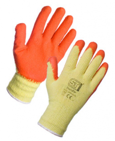

    Gloves
    Gloves are a must. your hands will quickly become sore and between the digging, pinching and mixing, concrete etc you will have blisters in no time. You pick them up in any builder’s yard for £2 a pair.

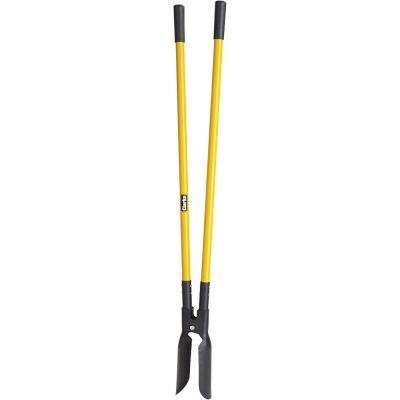

    These are also a god send for smaller post signs…..

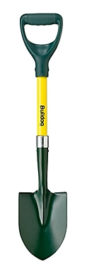

    June 15, 2022 at 9:36 pm
    I agree Craig, digging Spoons are very handy mate. I tend to only use them on holes over 650mm.
    I actually broke a pair of ours just before the initial lockdown period. similar to the ones in your photo!
    We had ours for years, so I thought I would replace them with a pair of the ones I have attached below.
    My logic was they were a nice heavy-duty well built set. Man was I wrong! these things are a nightmare.
    the weight of them, coupled by the position of your arms operating them out in front of you, add the weight of the dirt, and after a few goes with them you feel like your arms are going to explode! 🤣
