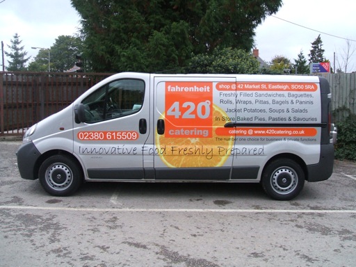

    It’s been a while since I had something decent to post, I have been wanting to do a vehicle using digi print (wrap) and cut graphics for so long and finally one of my customers upgraded their van and wanted something done on it so this is what we ended up with, they sent me the basic layout and I added in the orange and tweaked the layout a bit.
    Hope you like it.

    Hi Warren

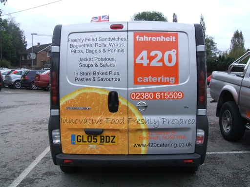

    I like the design very eye catching, just 2 points I would have moved the black line of text with FOOD in just a tad more to the right in the top picture to avoid the door gap and the text on the rear doors looks a little on the large side, no one else would ever no so its not a worry.

    Well done Warren, looks great.
    Just one crit, I think you could have reduced the size of most of the text, it looks a little like it’s all trying to bust out of the panels.
    Also the strapline on the rear could be smaller so as not to go from door edge to door edge.
    But as Richard says the layman won’t see it.
    Again, great job and it does look very eyecatching, I like the digi print alot.

    Thanks Guys

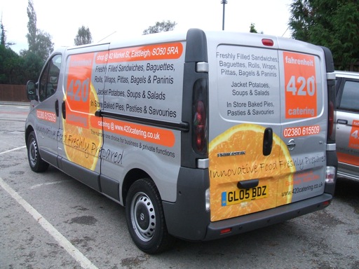

    I never got to see the van before I did it and worked directly from a vehicle outline template and it all fitted in much nicer and no where near the edges as it turned out, also was missing some of the badges on the template and also the number plate was on the other side so I had to change a few things to get it all done. I couldn’t believe how far out the vehicle outline actually was 😕
    The print was fine to apply, I’m loving this printed wrap material and really enjoy fitting it, the back was tricky but no problem really.

    30 September 2008 at 20:13
    Warren I do fit a lot of these vans and the monvano, the rears can be a paint to line up due to drop to the centre on rear panels, the monvano is a real pain. What material was the print on?
    Was it laminated ?
    if so did you fit with no app tape ?

    30 September 2008 at 20:22
    Print was on Arlon Xscape and laminated, applied without application paper (not sure if you can apply wrap vinyl with app tape 😕 )

    30 September 2008 at 22:01
    The top one could have done with about half the amount of text on it, or a more modern font. I imagine it was one of those where the customer got his way to the detriment of the design?
    Your own van is superbly fitted, it does look a bit like an events company or party organisers though, rather than signs.

    30 September 2008 at 22:05
    Yeah, all the fonts are what they always use for all their branding and is always the same, they also wanted all that info and at that size too, I tried to make it smaller but they asked me to change it back 👿
    They were over the moon with it as was I, it looks really really good in the flesh.

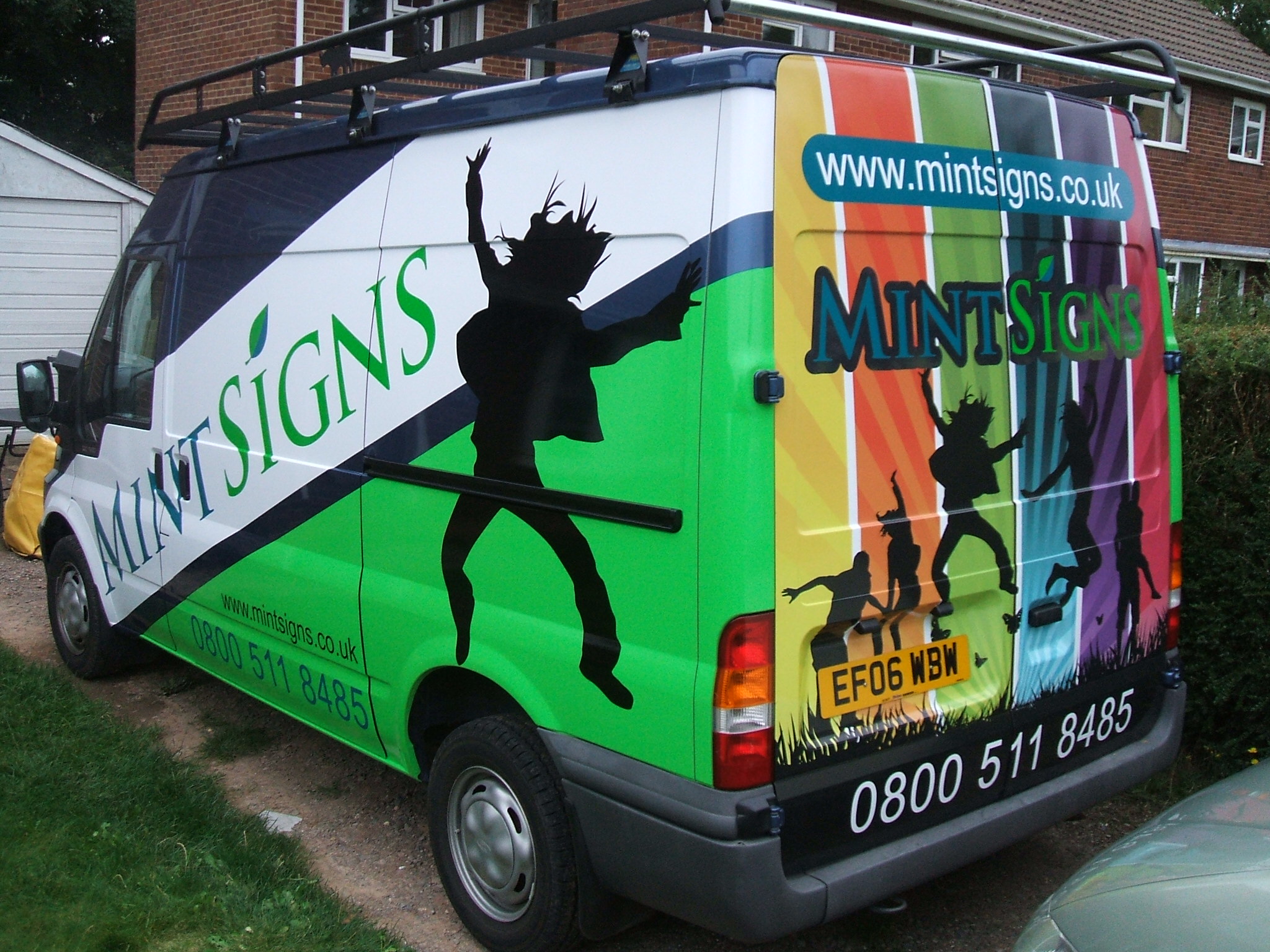

    Hi Warren,
    i think you’re right to have tried to reduce the text size, I like the over-all look and layout, but the text just looks a little too much for me, But, if the custoer is happy, and got what he wanted, then who are we to stand on a soapbox and criticise him!?
    good work though, you’ve more confidence then me with wrap stuff! i really should try and afford myself a class, if only to improve general vinyl app,
    re the outlines,
    someone told me to use them as a guide only for showing layout. where possible take a measurement from the van to scale it correctly, and if ya can’t do that, then scale it all down 10-15%.
    happened to me on the "it’s a dogs life" van, al too big, got away with it, but not ideal!
    keep at it dude.
