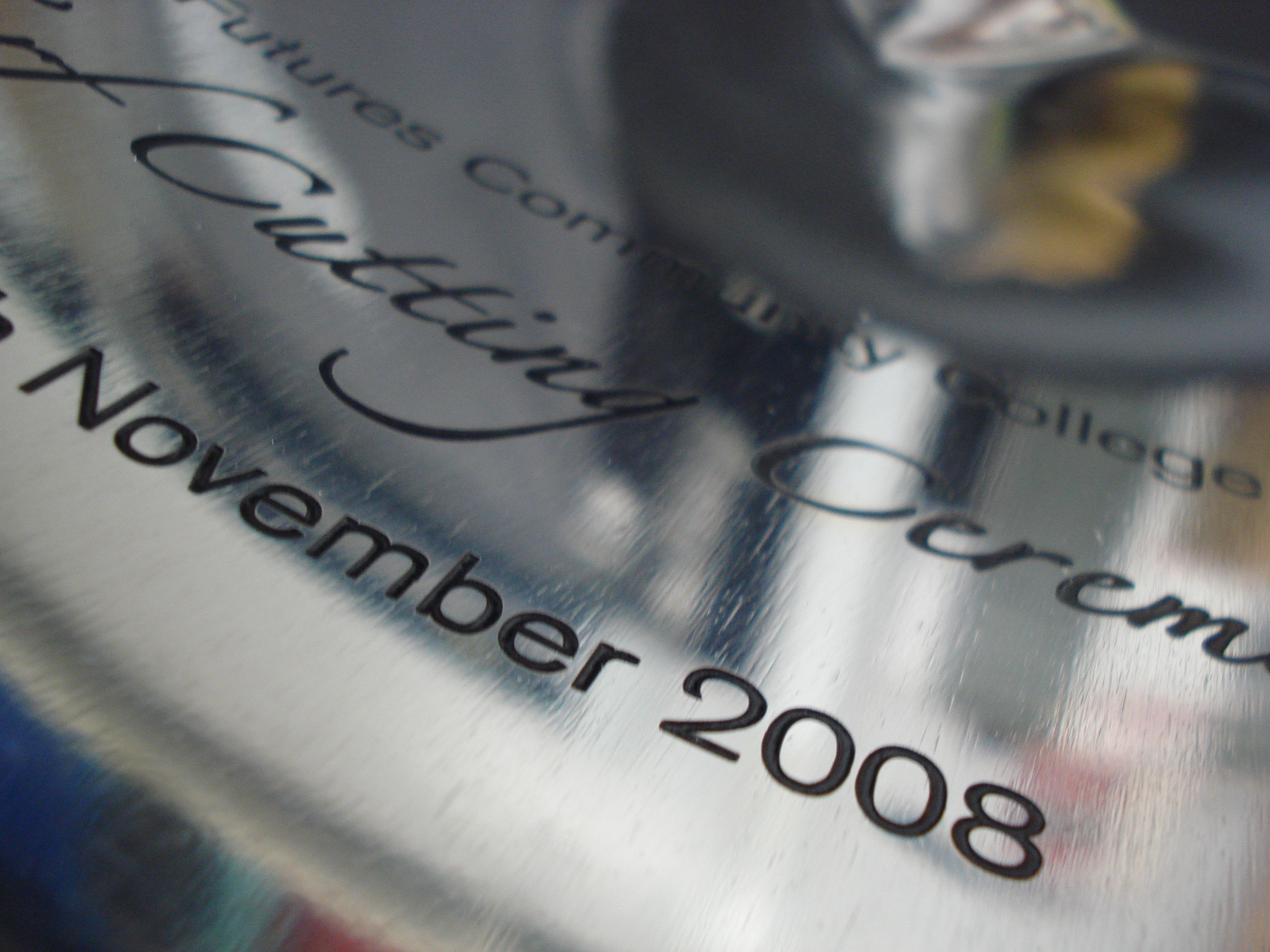

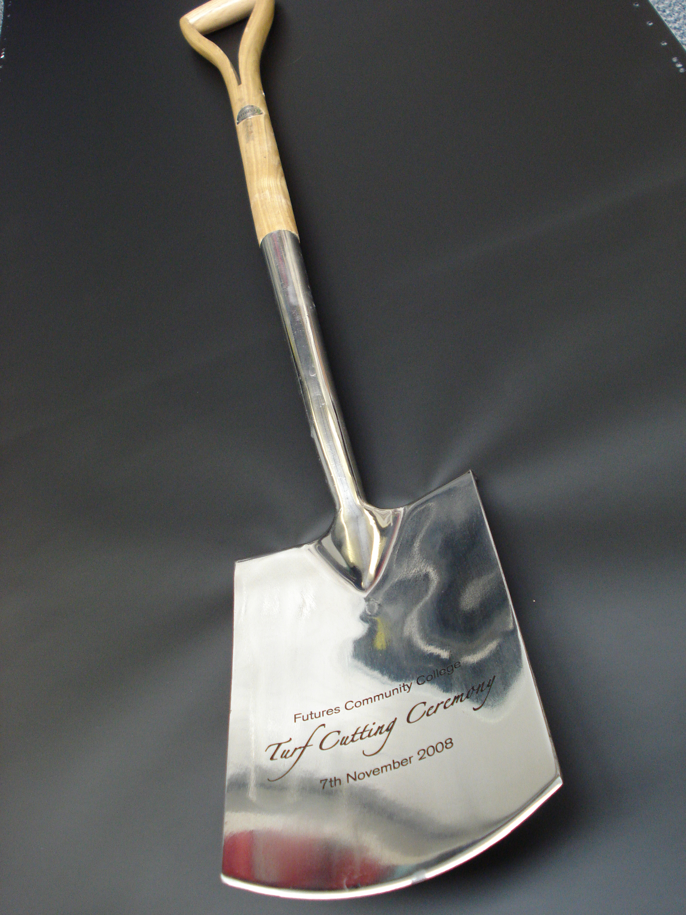

    Here was something just a little different.
    We do engraving and etching on a daily basis, but usually just on brass
    and stainless steel plates. We had a call from someone asking could we
    etch a spade !!!! It’s being used as an award.
    We had to make sure it was done right first time, and came out very well.

    Out of interest, how do you keep the edges so clean? My only experience of etching is using small blue non-sticky masks for part identification, but tended to get bleed around the edges. It wasn’t that important for that use but would have looked awful on something like that.
  • Adrian Neill
    24 October 2008 at 08:20
    we ‘just’ cut a negative template from vinyl and apply it to whatever we
    want to etch. Then make sure the rest of the item is masked up, usually
    again just using vinyl so that the acid doesn’t touch any other surface.
    ‘bung’ it in the tank for however long and hey presto one etched plate.
  • Adrian Yeo
    24 October 2008 at 08:34
    Ahhhh, so its immersion etch rather than electro-etch then?
    Different acids for different alloys?
    The kit I have used was a manual pad, only about 2" X 1" in size used like a wand.
  • Adrian Neill
    24 October 2008 at 09:39
    The system we have is we have a tank and the plates are placed around
    the outer edge. The acid is ‘swirled’ around the tank to create a mist.
    This mist is what etches the plates etc.
    I think that’s right anyway. :lol1:
