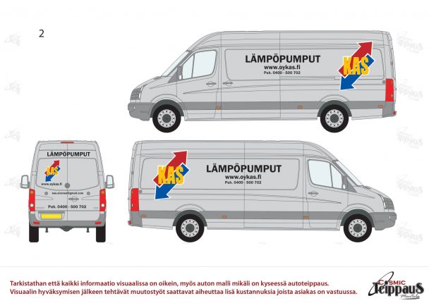

    I’d feed that in.
    Apply the flat part where the KAS is, then work down, right into the bottom of the recess, then roll it round onto the lower panel. Same on the top part.
    Make sure it’s nice and clean, and a bit of heat once it’s applied won’t hurt.
    Provided you’re using a half decent poly it shouldn’t be a problem.

    Exactly what i would do David. And have done in the past. I just keep seeing more and more cast used being used for more simple installs like this. It has me questioning myself sometimes.
