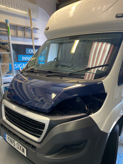

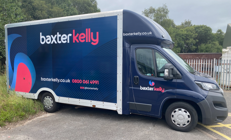

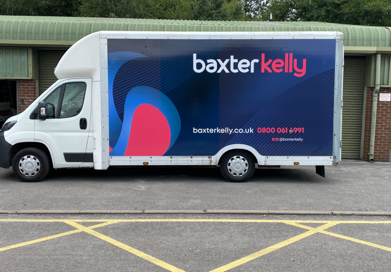

    I wrap a fair few lutons, front deflectors are the hardest part, we have a 3mtr roller shutter so are limited. Sides are done in the car park if you have access to a flatbed truck you can pull alongside and reach every bit nice and easy! we then bring the front cab into the unit to wrap we let the air down on the from tyres and slowly bring the front 30% inside then use clear sheeting with magnets on the roller shutter and tape to van side. Not ideal and we are looking for bigger premises. I have 8 booked for next month would be great to get them inside but space is expensive!
