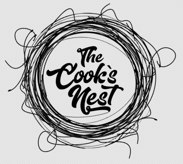

    I have a logo that is going onto a large box van, the design is like a birds nest so not really a cut vinyl option. Would it be best to print an oval with a black background? only problem is the van has a matt finish.
    I did think about printing white onto matt laminate? anyone done this before?
    I have a Mimaki UCJV300 with white

      Thanks David, am I being lazy or would you attempt to cut the attached out of white?
    July 21, 2021 at 12:26 pm
    Depends how big it’s going, and how thick the stroke is.
    It’s possible, a bit tedious I’d imagine if it’s small. Use a thicker stroke just to get rid of some of the much smaller gaps, leaving all the big bits to weed out.

    Just print white on clear as you said with a matt over laminate… and cut as a circle. Print, laminate & cut. Weโ€™ve done that numerous times and all good.

    As long as it’s a decent size I would just cut it in vinyl, weed it and fit.
    Does your printer have white ink?
    If you print onto clear, then matt laminate you have two layers of vinyl and ink costs.

    Metamarks MD5 laminate in also printable.
    If you print on clear, I’d merge it all and offset the cut path a mm or two, will look tidier than a big circle.
    Or cut and weed it ๐Ÿ˜„ either way is fine. I’d cut it myself, mainly as I don’t print white, and this is the kind of work we do, and are geared up for it.
    Rob has a point about the extra cost, but I suspect you’ll save that in weeding so will be pretty equal.

    Yeah, that’s an advantage then, fair enough Adam. I would create an outline around the graphic then rather than an actual hard to the graphic kiss-cut, or those wirey strands may become a pain.
    Also, as its clear, watch for fingerprints on the adhesive side when installing as they show up once applied and obviously impossible to remove. ๐Ÿ˜ฌ

    Personally I would print & bubble cut this, thin lines like that wonโ€™t last long with an over zealous pressure wash.

    Cut that. Its not that complicated. Half an hour each to weed.

      As long as they were big, I would most likely cut it in vinyl too, Simon.
      As Kev says though, at very least you would need to advise the customer a pressure washer over some of those lines are a no-no!

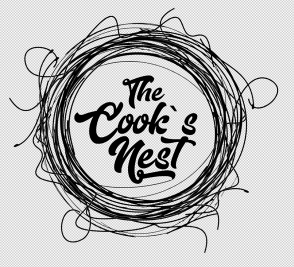

    save my sanity and pull that “S” in closer to the K in Cooks.
    It looks like the “S” is trying to “fly the nest” ๐Ÿคจ๐Ÿ˜€
    let us know how you get on Adam, would be good to know/see how you got on mate. ๐Ÿ‘

      Thanks Robert, After sleeping on it I am going to price it for print and bubble cut, as there are four of them at various sizes I can see the cut and weed option being a drain on time. I love the feedback on here, ill let you know how it goes if he accepts my price ๐Ÿ˜Ž
