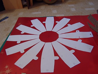

  • Joe Wigzell
    21 November 2013 at 09:15
    Hi Rob,
    Something that might be worth a try –
    split your artwork into sections with a nice big cirular piece on the bottom, I’m guessing if they’re going on poles they’ll be up in the air and mianly the bottoms and sides will be showing? Maybe split into 4 sections which will be easy enough to wrap, cover from the bottom and hey presto? Stick the logos on after?
    Another method that sometimes works for helmets etc, but might bee a bit tricky as the bees look pretty big – Have you tried stretching the vinyl, sticky side up over an open hole (large bin or something) and fixing at the edges. Heat til nice and stretchy then push the bee into the stretched vinyl and pinch at the top. not easy to get right but gives you a smooth finish.
  • Robert Walker
    21 November 2013 at 10:00
    The Bee is 1meter long,
    Joe i was thinking the same along a beach ball or globe shape
  • Joe Wigzell
    21 November 2013 at 10:21
    That looks like what I had in mind! Bee good to see how it turns out.
