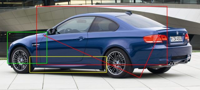

    panelling for wrapping.
    have a look at the photo attached of the car. if its a coupe, like shown. you will need a single piece of vinyl to go from around the corner to the inside of the boot at the light, and over and down the window pillar at the front. you may get to include the door in that, but that will depend on how you intend bringing the vinyl in from the back to the door and “into the door jam” in one bit, or cutting down the gap of the door and folding in the 5mm flap with a join in the door jam.
    also, keep in mind the probability of the boot interior needing wrapped too. not a lot of vinyl, but not easy unless the boots removed too.
    hard to explain, but when all these things are taken into account, 17 metres can be easily swallowed up and not priced for.
