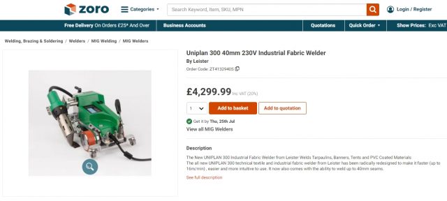

    I purchased a Leister Banner welder about 20 years ago now. My thoughts were exactly like yours, save on tape, speed up production etc.
    However, there is a real knack for using them properly for “one person” with big banners. The process is simple enough as you can see in the video, but the video does not show you the 600-degree heat jetting out the side of piping-hot metal parts. ๐Ÿคจ I burned myself a good few times during that learning curve. ๐Ÿคฃ
    You need a large dedicated area to be able to manufacture them. So I assume the volume of banners you are putting out, must be high?! Do not get me wrong, although I would make whatever size banner that came in, about 30ft x 15ft was as big as was needed. So it was no way as big as far as building wraps go.
    Long story short, we still do banners, still make them up to those sizes and we still use the tape. Not in the same volume as we did back then, but still.
    My banner welder was sold on this website about 4 years ago, and was in perfect condition because it was hardly used.
    the picture I have listed below shows it at about ยฃ4000 but you should be able to get them cheaper from Liester directly, maybe! I am sure I bought mine directly from Liester, as they were exhibiting at Sign & Digital UK.
