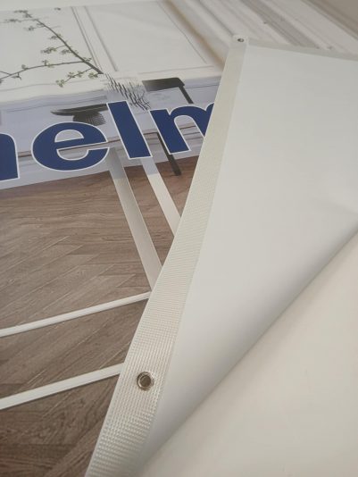

    Hi folks, so i have always used the traditional tape and fold method for eyelets in my banners. Over the years i have never liked a few features in this method, 1-tape seems to crease when banner is rolled up, 2- tape doesnt always hold up to our cold winters.
    Now i have some edge it tape, this seems much stronger, i like the finish better without folded edges and it doesnt seem to crease when rolled. But… the price of the stuff, atleast here is a lot on a finished product that doesnt have the highest margins.
    So today, being a cheap skate i was thinking….. is there any real logical reasons you cant just use edge it tape in the areas the eyelets are going? say 50mm squares at each point? i’m expecting a reason why not but apart from maybe the banner being more flimsy/wavey between the points and not looking so good?

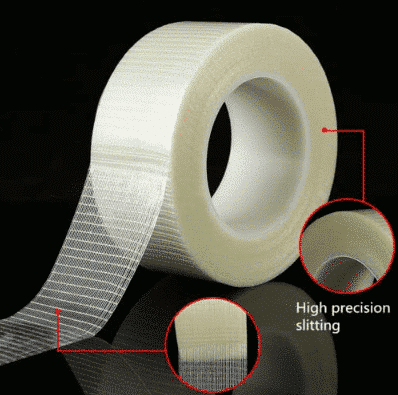

    The one you show in your pictures is a bit different from the one I use.
    The one I use is smooth and has a thin nylon feel to it. its purpose is for strengthening, but comes in different thicknesses, so can be used just for finishing as well as strengh.

    Only thing we find sometimes, is that the edges of the banner tape has the reinforcement fibers showing, and can lead to ‘furry’ edges when they fray – haircut with scissors sorts it out.

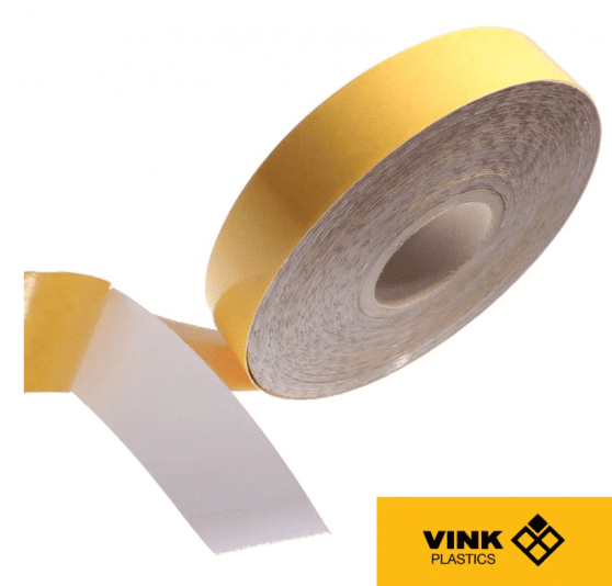

    4 February 2025 at 23:17
    @Colin-Crabb-1
    Is this similar to the hemming tape you use, Colin?
    I used a similar one in the past, it is a really strong tape. I got it from Vink. This reminds me I should get some more back in. It is also great for bonding correx.

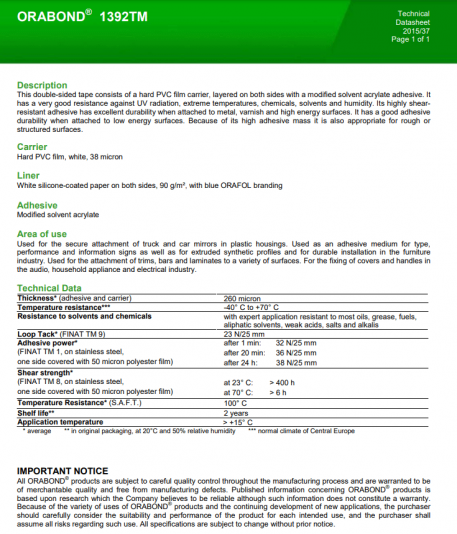

    Orafol 1392
    White double-sided PVC tape and a clear 350-micron PVC.
