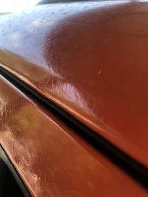

I’ve been called in as a consultant to advise a fleet owner if his wrap material is faulty or is it an installation issue. I know the guy that fitted the wrap, and I could say without even seeing the wrap, that it would not have been an installation issue as the installer is one on the best in the game here.
Seeing the vehicle, it had what could best be described as an elephant skin texture, so I rang Spandex who arranged the fleet contract installation, to advise them that their client seems to have a claim. The client had already asked the sign shop that fitted it to make a warranty claim, but they refused. It only had a few weeks left on the warranty, and they didn’t think the claim was justified, telling the client that they must have put it through a car wash. He hadn’t.
