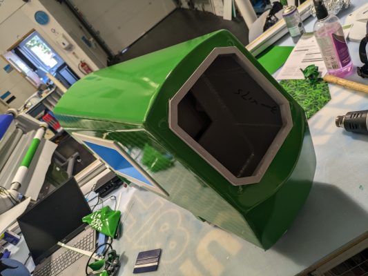

    Not a vehicle, but I printed this yesterday with the temp reduced to 90, laminated this morning and fitted straight away. Another warm clammy day, and it didn’t seem to grab as much, tomorrow’s job has been postponed so I may do some side by side tests with an offcut of this job and the last two van printed at 112.
