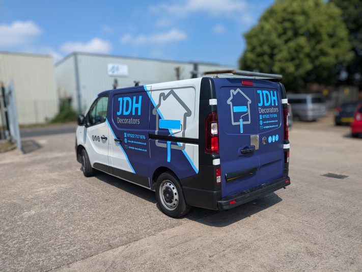

    I’ve used Arlon SLX previously, but after a competitive price on the 1105 EA RS, and really enjoying working with it down the Spandex course, I bought a roll.

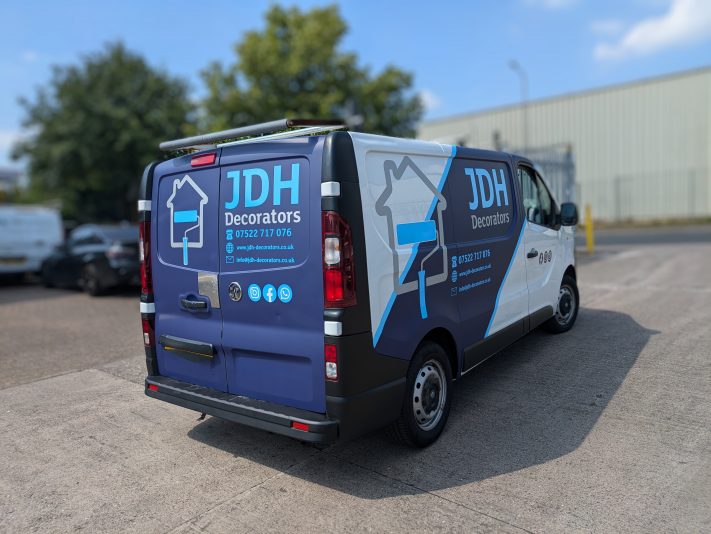

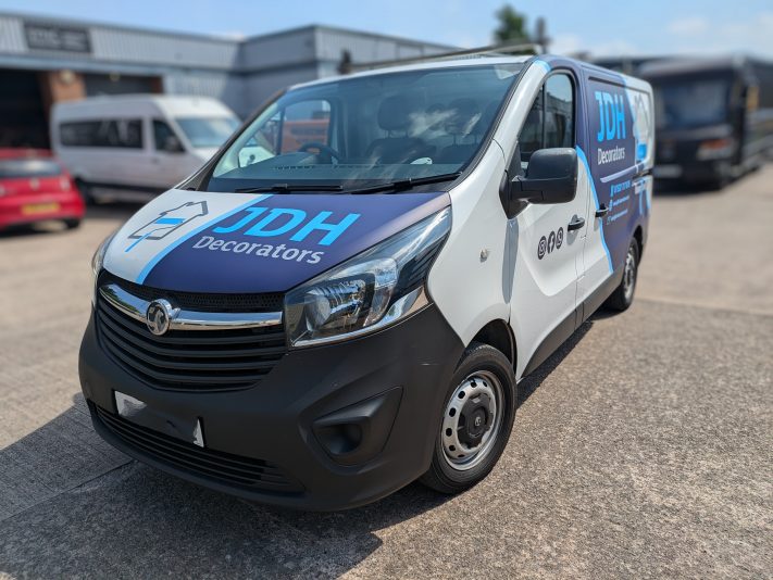

    Yesterday installing the attached livery, the initial tack was quite surprising. Laying the vinyl onto the van to ‘bed sheet’ it, I wouldn’t say it glided, and repositioning involved a good tug to break the bond, from it just sitting there.
    The only think I can think is the unusually warm weather, with the workshop around the 25 degrees.
    I tried some Avery Supreme I had lying around when my rep popped in and the same there.
    I don’t recall it being so tacky on the course or when using the ASW in the past.

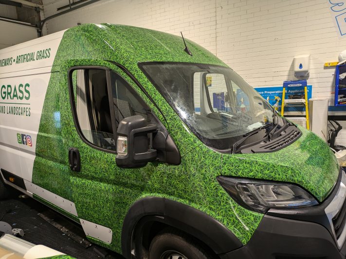

      Certainly caught me off guard, but I got it laid, the drivers side was far more challenging than the passenger side. Almost felt like when inks hadn’t outgassed… But it was printed on a latex.

    Great design. like it aaa lot.
    How did you do the groovy photos taking out the background, photoshop? makes a big difference
      June 27, 2024 at 4:31 pm
      Cheers Martyn.
      I was working on the original design, and I saw a van on the way into work that had a band and it got my attention, so that’s where the idea came from. Granted it used a few meters more of material.
      To blur the photos I just use the portrait blur option on the Google Photos app, and the magic eraser for removing number plates 👍

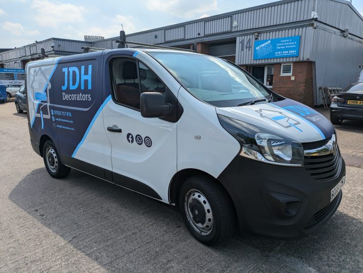

    At it again, with 1105, warm but not as warm as the last van… Jeeeze pulling our hair out especially the part over the roof. Bed sheeting the vinyl isn’t an option as it sticks as soon as it contacted the paint, and bubbles galore on the bonnet, the pattern didn’t help, but it’s as if the air channels had collapsed.
    July 18, 2024 at 9:09 pm
    One other thought… The vinyl is printed on a latex, I haven’t adjusted the heater settings from the profile I am wondering if the heat is too high and affecting the adhesive on the vinyl?

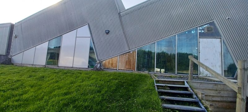

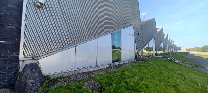

    Here is a job I installed last week.
    Simple, flood-coating windows using Oracal metallic silver to resemble the finish of the building cladding.
    these windows are on old factory units holding nothing but tyres inside, they already have window film on the inside, some windows with wood behind them, some cracked etc. they just want the mess hidden.
    I arrived at about 3.30pm, the sky was pretty clear and blue, it wasn’t hot at all and the sun was already over the back of the units, but it was humid.
    The first thing I did when I arrived was to feel with my hand if the glass was holding any heat. if anything, the glass was cool.
    The vinyl was all taped up using Oracal paper application tape, so the vinyl will be easy to handle.
    I had told the lads preparing the vinyl for me, “Not to bother trimming it down to size, I’ll trim the overhang of vinyl, once it is installed” This was because each window was 47 inches wide, but the roll was about 49 inches wide.
    First, the windows were blade scraped, then pressure washed down with soapy water, water squeegee dry, and then wiped with Isopropyl alcohol.
    I never apply vinyl with any application fluids, ever. So I am applying full-width panels of taped vinyl directly onto cool windows on a humid day.
    However, as soon as I touch the glass with the vinyl, it is “stuck, on contact”.
    I instantly knew this was not going to be easy and I already knew I was chancing my arm because of the humidity, but I went for it anyway. 🤨
    I had planned to complete two units, (16 windows) by 5.30pm then head home, but I only completed the first unit!
    I had zero problems other than the fact the vinyl was sticking on contact, so I had to make sure I took my time because I didn’t want to miss a squeegee swipe. Because the vinyl would not have lifted without stretching or snapping. I don’t use air-release coloured vinyl, so I had to make sure I didn’t get any bubbles either. the whole job had us both under pressure because there was zero margin for error.
    To make matters worse. The excess vinyl that I had to trim off down each side of the glass… “it wouldn’t come off the aluminium window frame” The lad that was with me was at my back trying to get the vinyl off as quick as he could because of the bond was building up and it was coming off in small bits.
    The job took me more than twice the time I had in mind and I know it was the humidity that was ultimately to blame. My point is, that this was not printed, laminated, or an out-gassed material. Still, it stuck like shit to a blanket.

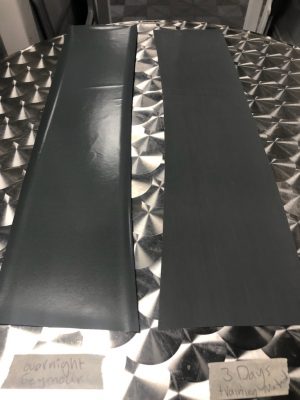

    I’ve attached the pic they sent showing the vinyl curling, which I’m told to ‘out gassing’. I should get a call today from Spandex to chat more about it

      The vinyl arrived with him by overnight courier, and he first removed the backing and did the finger test (poke it and see if it sticks) and it did, unlike the samples they printed and use for training down there. ~
      Next he left the vinyl as shown in the picture overnight to see what happens, mine’s curled, there’s hasn’t – He believes this is an out gassing issue (yes printed on a latex) despite coming off ‘dry’ moisture may have become trapped on the take-up, and trapped when laminated the following day.
      He’s tried installing the vinyl, and agreed it’s bloody awful to work with, resembling a cheap polymeric, with an initial high grab, air channels not working, the glide not working, nothing like the 1105 samples they had in house. He’s tried them in their training facility, which is a controlled environment, not too hot or cold, using the appropriate cleaners etc, so it kind of rules out the ‘ambient temperature’

    The vinyl curling like that is possibly over-tensioning during lamination.
    If it’s warm laminated in a humid room, it will make the vinyl or laminate more prone to stretch, creating surface tension.
    However, surface tension during lamination can also be created even in cool working environments, it’s just as it sounds, a bit more tension on the roll. hence why I’m saying, that if you remove it from the liner and sit it down and you see curling, it is possible that the laminate is causing that.
    This is not an answer to you having tacky vinyl, this is purely based on the curling.
    However, latex water-based ink should not be capable of having such an adverse effect on vinyl in the way solvent can.

      I agree, the pieces I cut last night and left on my bench don’t seem to have curled.
