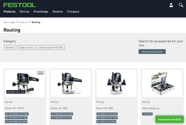

Just searched it on the Festool UK site. https://www.festool.co.uk.
You may have a Festool dealer near you. I’ve got three near me who was as much use as a box of rubber spanners. I found a dealer in South Wales called Timberman Ltd. A really helpful guy called Mike who like all the other dealers had never heard of it let alone seen one, but unlike the rest he was willing to move away from his desk to get one for me & was kind enough to just charge £50 over cost. I bought a 3m & 1.2m guide rail & a vacuum extractor with it & it’s a good kit. Expensive stuff but worth it when a sheet of millable ACM is around £35-£40, it doesn’t take long to pay you back. Also, you can mill the sheet then wrap it edge to edge before folding. We rivet the corners with a piece of 40mm angle, glueing isn’t really necessary, all the trays I’ve bought in crack like bubble wrap when carrying anyway so I’m doubtful that the glue is really doing much at all. My lad can route an 8’ x 4’ & fold & rivet in around 30 minutes now.
