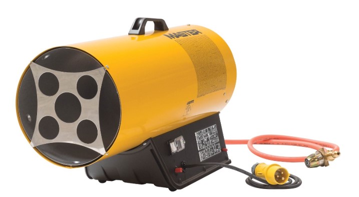

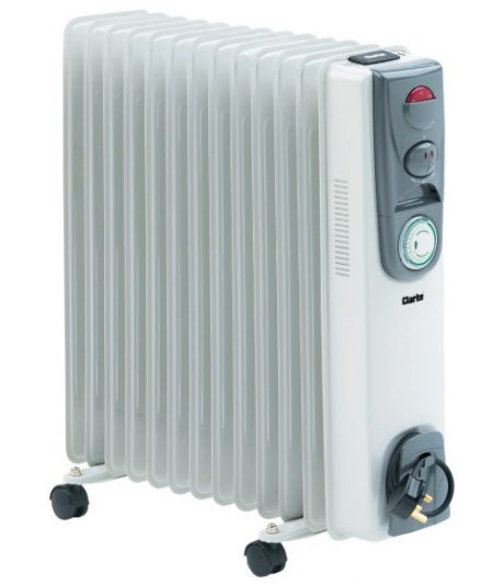

    even my fitting bay with a gas heater would get cold, and the fumes would be a bit much if spending several hours in there.. my preferred option (at my place) was to put an oil filled rad in the back and leave it overnight, it warms it nicely from inside out, more importantly, evently. A heat guns’ heat is lost almost as soon as you remove the gun.

    we have a gas space heater and you are right, after a while the fumes start to sting your eyes.
    if you turn it off, the room quickly gets cold again. 😕

    As Colin says, some form of heater in the back of the van is a good way to keep the chill off of the panels of the van, on the outside.
    The likes of an oil-filled-heater is a good option. but the key point is to do it at least 30 minutes prior to lettering the vehicle. Pop it in the back as soon as the van arrives. it gives you time to clean down the vehicle, take sizes and mark it, then when you get to fitting the graphics the severe chill of the metal has reduced or gone.

    space heaters are great for blasting the room with warm air. but as has been said, they can overheat the space depending on the type and size as well as nip your eyes or gradually be uncomfortable to work with. However, ide rather have that than a frozen room fitting vinyl.
